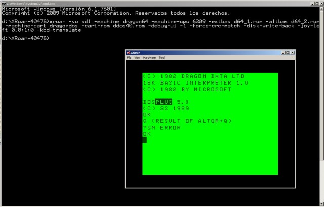

for maybe it could help, this is the screenshot of the start of xroar (under windows 64)
with the option you told us to use.
I don't know where to find any debug trace ... sorry :-(
Re: xroar keyboard mapping for windows 7
Posted: Thu Sep 28, 2017 10:39 am
Have you check the stderr.txt and stdout.txt files on your XRoar folder?
