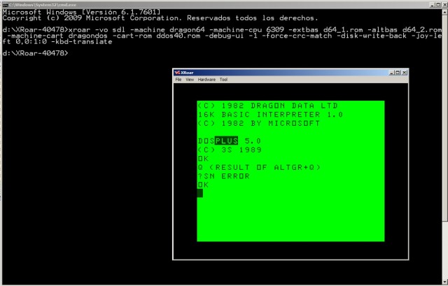

for maybe it could help, this is the screenshot of the start of xroar (under windows 64)
with the option you told us to use.
I don't know where to find any debug trace ... sorry :-(
