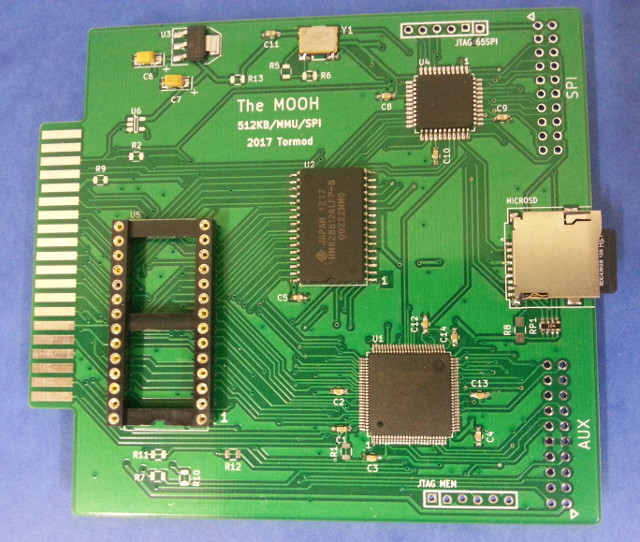

As soon as I had the Spinx-512 board working correctly, I started on the successor but due to the VCF and everything that followed, the development was stalled for a year, with mainly just some PCB routing left. The last weeks I have picked up on it and here we go:
The MOOH - a 512 KB memory extension + SPI interface cartridge board. Sounds a lot like the Spinx-512, no? So what's different?
- a ROM socket - for booting without DriveWire or MPI
- the "nx32" banking scheme is ditched (no compatibility with spinx-512 or the +32K board), instead:
- a DAT (dynamic address translator, or MMU) pretty much compatible with the one in the CoCo3!
The 65SPI-based 4-port SPI interface (and SD card socket) remains the same
It was easy to tweak the FUZIX dragon-nx32 port to run on this board (with the same 32KB banking) but of course the main target is the long-time wet dream of running NitrOS-9 Level 2 on the Dragon!
The MOOH memory & SPI board

I will post in the "Sales" section when it is ready for the "general public". But I am happy to already serve early adopters who can live with some potential upgrades and exchanges. Until we have SD-card/SPI drivers for NitrOS-9, running NitrOS-9 will require DriveWire or an MPI for other mass storage options. FUZIX supports the SD-card already, and I have a boot ROM that should boot from the SD card, as soon as I get to burn it. FUZIX already runs on the MOOH by putting together "nx32"-like 32K banks, but a more streamlined port can, like the CoCo3 port, use smaller banks to allocate memory more efficiently.
The DAT/MMU is exactly like the one in the GIME in that it has 2 tasks, the task registers are at $FFA0-$FFAF, the DAT is enabled at $FF90 bit 6, the CRM* at bit 3, the task is selected at $FF91 bit 0. One small difference is that when the CRM is enabled, its upper 16 bytes are also seen at FFFx - so that the vectors can be directly programmed. This because on the CoCo3 the ROM vectors point to the CRM, but on the Dragon and CoCo1/2 the ROM vectors point to $01xx and this is not practical when we want to map various stuff in the $0000-$1FFF segment.
*) CRM: Common Reserved Memory vector page, a page that stays at $FE00-$FEFF regardless of the current mapping through task registers. Typically used for interrupt handling code.

Re: The MOOH memory & SPI board
Pere, who could possibly need more than 512KB of RAM
Yes, I have also looked at it from a cost and complexity issue. I think a lot more people will prefer an affordable 512KB option. Personally I wouldn't investigate in larger capacities unless there is a solid base of software to take advantage of it. Now we have this hardware, but there will be a several years journey to fully exploit its possibilities, adapting and building software around it. For multi-tasking, having 16-32 processes in memory sharing one poor 6809 sounds enough. Fast SD cards obviate the need for RAM disks to a large degree. I am not even sure e.g. NitrOS-9 can use the memory beyond 512KB for anything else than RAM disk. But hey I know, some people will always keep wanting more :-p
Pere, the ROM is a 27C512 type, so 64KB, with some kind of software selection of what comes up at $C000 (not tested yet).
The SPI interface is to a large degree documented in the links in the Spinx-512 post.
Another GIME feature that might just fit in your design is the timer - not sure if NitrOS-9 Level 2 uses that at all. And of course you don't get the option of programming whether IRQ or FIRQ is triggered: FIRQ or nuthin'.
Even without it, this looks like a cool project though.
Thanks!
Of course, the MOOH board doesn't fully turn your Dragon/CoCo1/CoCo2 into a CoCo3. The CoCo3 has additional graphic capabilities and timer and keyboard interrupts and fine-grained interrupt source selection. Anyway, the timer is not used at all in NitrOS-9 AFAICS. The kernel does not need it and from grepping the source it seems to be no system interface to it. And keyboard entry works without keyboard interrupt.
There was actually surprisingly little work needed to get Level-2 to run on the MOOH. I spent most time on tweaking the keyboard scan routine for the Dragon keyboard. I ended up with a hack transposing the keyboard row order inside the scan routine, which preserves the scan codes, and of course adding some modifier combinations to replace the extra keys on the CoCo3.
For anyone interested see the attached patch of the system modules. It is an intermediate version just for illustration, I have since moved the VDU address, and it also doesn't contain the build tree and defs file. In my current tree I keep separate copies instead of patching the common system modules, so the differences are not so easy to spot or generate. It will end up in the NitrOS-9 repo soonish, but just let me know if anyone is interested in building it. I will also post the XRoar patch for the MOOH memory emulation.
