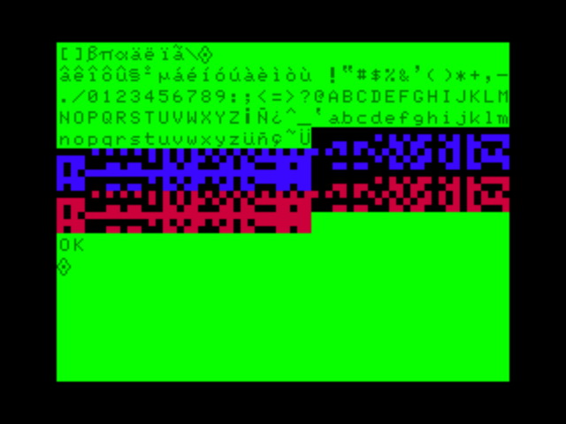

I'm almost there with this, but struggling with the semi-graphic colours. Any ideas as to what I'm missing here?

This is what you should be seeing if you write the following program:
10 CLS
20 FOR I=0 TO 255
30 PRINT CHR$(I);
40 NEXT
As far as I know, the semigraphic characters are automatically generated by the VDG and are not stored anywhere, so you may have an addressing issue there.
Re: MAME - Dragon 200-E
Posted: Mon Jun 12, 2017 3:36 pm
by prime
In sg4 IIRC d7 also goes to the a/s pin on the vdg, and then bits 0..3 select one of 16 patterns. Bits 4..6 select 1 0f 8 colours. So I suspect if d7 is high and a/g islow all 8 bits need togo to the vdg.
