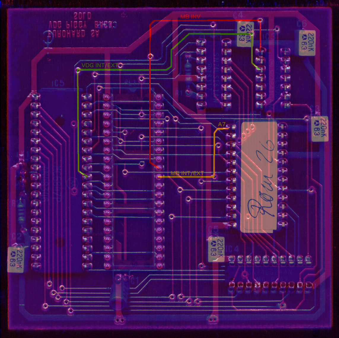

I wonder whether I need to do something with link LK1 to indicate that the external chargen is available?
Posts: 1703
Re: MAME - Dragon 200-E
LK1 switches between standard and inverse video.
The INT/EXT signal goes directly to A7 on the eprom, the INV signal from the motherboard goes to one input of the 74LS00 and the output from that nand goes to the 6847 INT/EXT pin.
What I think it happens is that, when a non inverse video character is requested, the 6847 switches to the external ROM. When an inverse video character is requested, the standard characters are used. The characters appear normal or inverse, depending on the LK1 switch.
I made a composite view of the daughter board, and also some annotations.
Please check the attached pictures.

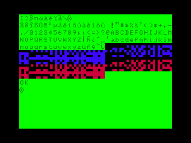

I'm almost there with this, but struggling with the semi-graphic colours. Any ideas as to what I'm missing here?
Posts: 1703
This is what you should be seeing if you write the following program:
10 CLS
20 FOR I=0 TO 255
30 PRINT CHR$(I);
40 NEXT
As far as I know, the semigraphic characters are automatically generated by the VDG and are not stored anywhere, so you may have an addressing issue there.
prime
Posts: 276
Post by prime »
In sg4 IIRC d7 also goes to the a/s pin on the vdg, and then bits 0..3 select one of 16 patterns. Bits 4..6 select 1 0f 8 colours. So I suspect if d7 is high and a/g islow all 8 bits need togo to the vdg.
