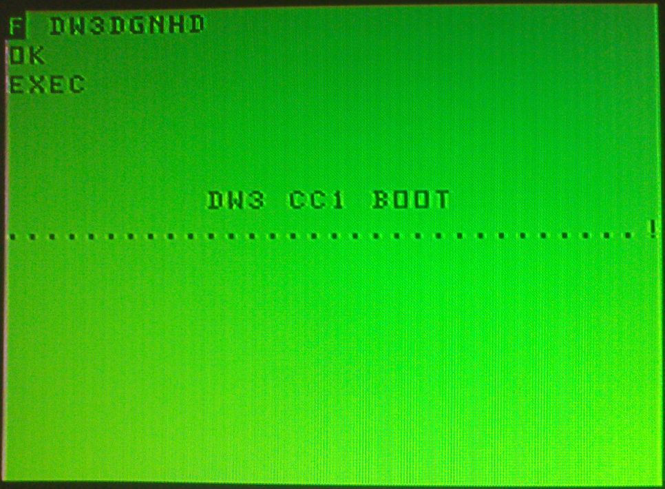

So I tried again yesterday. I loaded in drive 0 the hdbboot.dsk file, and in slot 1 the file Arcad01a.dsk, file found in this forum thread.
Launching the dragon, typed the usual commands (CLEAR 200,&H5DFF , CLOADM , EXEC).
I have some activity on the drive wire "reads" and "LSN" values, when the dragon screen is loading with dots. But the last point is replaced by a "!" and everything stops :
I don't really get what is wrong... It looks like the link is working, but the DOS program is not correctly loaded.
I tried an other file in drive 1, "games_01.dsk", also found on the same forum thread, but same thing...
I tried also to insert a "blank" disc (new file). The loading process is done (no "!" at the end), and I have activity on both drives, but the dragon doesn't do anything.
I am doing something wrong ??? The result should be to have the RS-Dos shell ???
