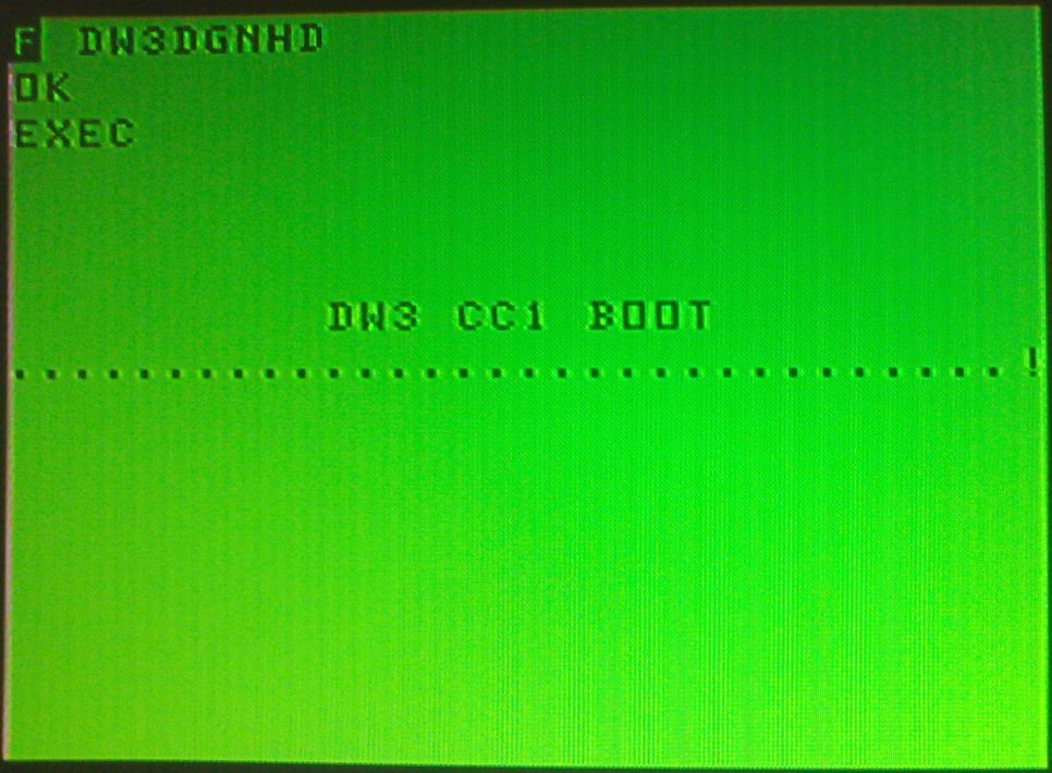

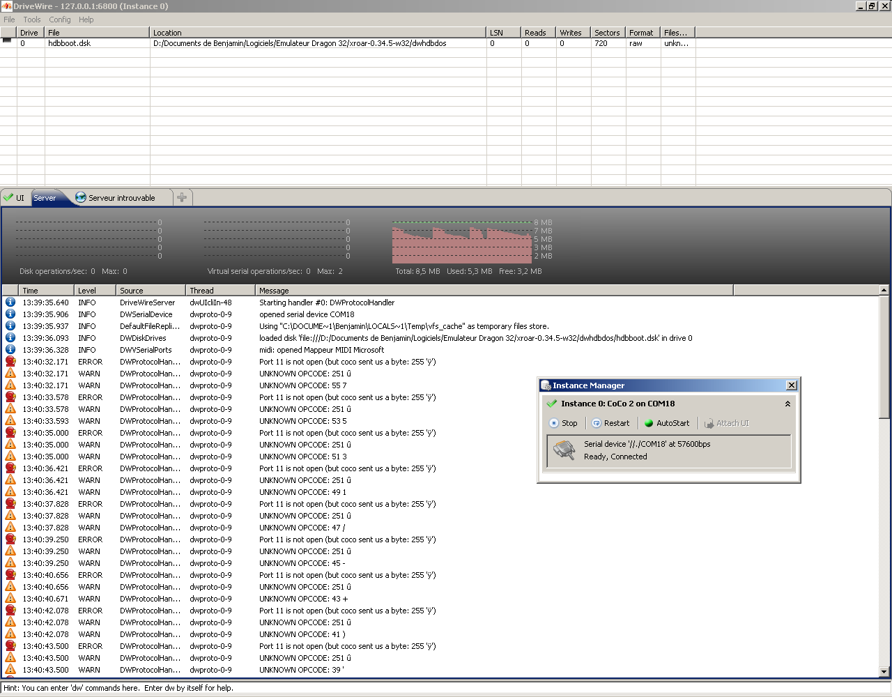

Ok, I tried again the DW interface but I still have some issues.
First, I connected everything (DW adapter and sound tape cables on the Dragon).
On DriveWire4, I created the server (Coco 2, 57600 speed and defaults values.), then I inserted the "hdbboot.dsk" into the server disk 0 (see screenshot).
Booting up the Dragon.
I typed :
Played the WAV (works better with CLOADM
Then typed EXEC when the loading was done ("Ok"). Looks great, I have the "DW3 CC1 BOOT" display.
But on the DriveWire log, I have some errors messages :
Then everything stops.
On the dragon, I still have :
Followed by a serie of "M" (about one per second)........ to finish with a "?"
It looks that there is a transmission, but something doesn't looks good. I don't see what is the "Port 11" ? My serial port is 18 (usb-ttl adapter).
Any ideas ??? Am I doing something wrong ? Thanks !

I typed :
CLEAR 200,&H5DFF
CLOADM
mar. janv. 03 2017 13:40:32.171 ERROR DWProtocolHandler dwproto-0-9 Port 11 is not open (but coco sent us a byte: 255 'ÿ')
mar. janv. 03 2017 13:40:32.171 WARN DWProtocolHandler dwproto-0-9 UNKNOWN OPCODE: 251 û
mar. janv. 03 2017 13:40:32.171 WARN DWProtocolHandler dwproto-0-9 UNKNOWN OPCODE: 55 7
mar. janv. 03 2017 13:40:33.578 ERROR DWProtocolHandler dwproto-0-9 Port 11 is not open (but coco sent us a byte: 255 'ÿ')
mar. janv. 03 2017 13:40:33.578 WARN DWProtocolHandler dwproto-0-9 UNKNOWN OPCODE: 251 û
mar. janv. 03 2017 13:40:33.593 WARN DWProtocolHandler dwproto-0-9 UNKNOWN OPCODE: 53 5
mar. janv. 03 2017 13:40:35.000 ERROR DWProtocolHandler dwproto-0-9 Port 11 is not open (but coco sent us a byte: 255 'ÿ')
mar. janv. 03 2017 13:40:35.000 WARN DWProtocolHandler dwproto-0-9 UNKNOWN OPCODE: 251 û
mar. janv. 03 2017 13:40:35.000 WARN DWProtocolHandler dwproto-0-9 UNKNOWN OPCODE: 51 3
mar. janv. 03 2017 13:40:36.421 ERROR DWProtocolHandler dwproto-0-9 Port 11 is not open (but coco sent us a byte: 255 'ÿ')
mar. janv. 03 2017 13:40:36.421 WARN DWProtocolHandler dwproto-0-9 UNKNOWN OPCODE: 251 û
mar. janv. 03 2017 13:40:36.421 WARN DWProtocolHandler dwproto-0-9 UNKNOWN OPCODE: 49 1
mar. janv. 03 2017 13:40:37.828 ERROR DWProtocolHandler dwproto-0-9 Port 11 is not open (but coco sent us a byte: 255 'ÿ')
mar. janv. 03 2017 13:40:37.828 WARN DWProtocolHandler dwproto-0-9 UNKNOWN OPCODE: 251 û
mar. janv. 03 2017 13:40:37.828 WARN DWProtocolHandler dwproto-0-9 UNKNOWN OPCODE: 47 /
DW3 CC1 BOOT
- error2.png (99.61 KiB) Viewed 7627 times

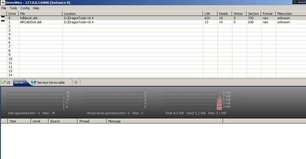

So I tried again yesterday. I loaded in drive 0 the hdbboot.dsk file, and in slot 1 the file Arcad01a.dsk, file found in this forum thread.
Launching the dragon, typed the usual commands (CLEAR 200,&H5DFF , CLOADM , EXEC).
I have some activity on the drive wire "reads" and "LSN" values, when the dragon screen is loading with dots. But the last point is replaced by a "!" and everything stops :
I don't really get what is wrong... It looks like the link is working, but the DOS program is not correctly loaded.
I tried an other file in drive 1, "games_01.dsk", also found on the same forum thread, but same thing...
I tried also to insert a "blank" disc (new file). The loading process is done (no "!" at the end), and I have activity on both drives, but the dragon doesn't do anything.
I am doing something wrong ??? The result should be to have the RS-Dos shell ???
Re: Issues with the driveWire interface
Wasn't there the need to have the disk images multiple of 256 bytes?
Robert is absolutely right!
All files need to be multiple of 256 in order to be read by the drivewire server.
We had this problem in the past and I uploaded a small Java tool that changed the header of
any VDK to make it be 256 bytes long, so that the file becomes DW compatible.
You could download it from this thread:
viewtopic.php?f=5&t=5363
Here you will find some info about my DosPlus5.0 extender which allows the user to
work with VDK as if they were normal floppy disquettes (under std DOS).
It is greater than 8k and 'needs' to be burned on a 16k ROM or loaded into RAM if you
are the owner of a Dragon-Tano 64
