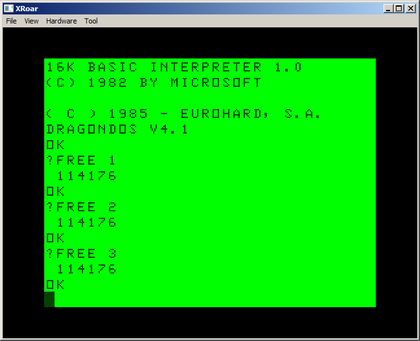

Hi Ciaran,
At this moment I am working with a program that has been made compatible with
DDOS11C, DDOS12A, DDOS13A, Eurohard4.1, DPlus5.0
But now I see that on the emulator (XRoar), it is not detected the non presence
of a disk into a drive.
I have loaded ONLY one disk into drive1 and asked for the free space in drives 1,2,3
This is the XROAR result:
WRONG FREE DATA.jpg (17.91 KiB) Viewed 5737 times
The result on the real Dragon is this one:
?FREE 1
 114176
OK
?FREE 2
?SK ERROR
OK
?FREE 3
?SK ERROR
OK
Is there any way to guarantee the right result on XRoar?
Thanks in advance

Seems to vary. Sometimes you get an error (I'm tending to get ?IV ERROR), but keep trying and eventually all the non-present disks get reported with the cached value. Given it can take a few goes, have you tested this exhaustively on real hardware and never got a bad result?
Edit: Hmm maybe it's the lack of seek error actually - I see it falls through to reading sector, where it'll get no data, and the previously read sector will therefore still be in that buffer...
Further edit: I see the problem. DragonDOS schematic ties "READY" high, so read sector should always begin, but then the constant "index hole" of no-disk should cause a seek error. Out of interest, how quickly is the error reported? Timeout is supposed to be 5 index pulses, but of course there's no rising edge if there's no disk, so I wonder how long it takes without them.
