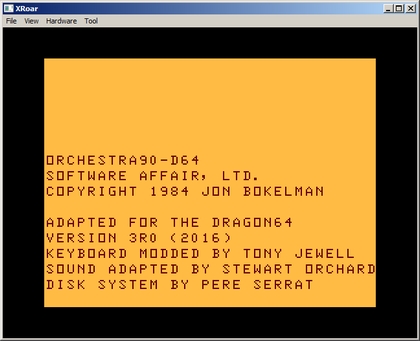

after a long time working on that project, we may finally present a working program.
We have converted the Orchestra90-CC for the Tandy CoCo to the Dragon 64.
- Tony Jewell modified the keyboard routines so that any keypress generates the CoCo code expected by the program.
- Stewart Orchard found a way and programmed the audio mods necessary to add the two channels signals (stereo) and
send the result to the internal Dragon DAC, so no need for the cartridge to be present any more!
Of course if you have it you can benefit the extra two bits definition and its stereo output.
He pushed a lot on the analysis part of the project, specially on the hardware related routines.
- I have added the code to deal with the drives natively, that means without any DOS being installed, sending commands
right to the chip inside the controller (WD2797)
This program needs a Dragon64 as it switches to all RAM mode (map1).

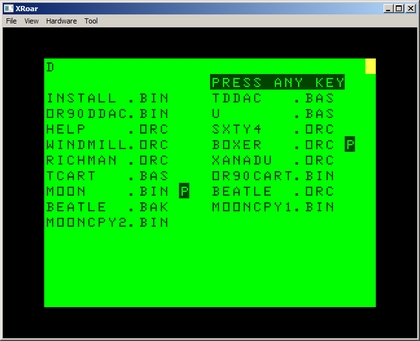

Some screenshots:
DIR command.jpg (62.39 KiB) Viewed 6583 times

The directory has been changed to show the extension too, as you can see in the screenshots of previous message.
The program accepts * as a wild card, so you can
D 1:*.ORC will show ORC files in drive 1
D *.BAS:2 will show BAS files in drive 2
D *.* will show all files in disk 1 (default)
