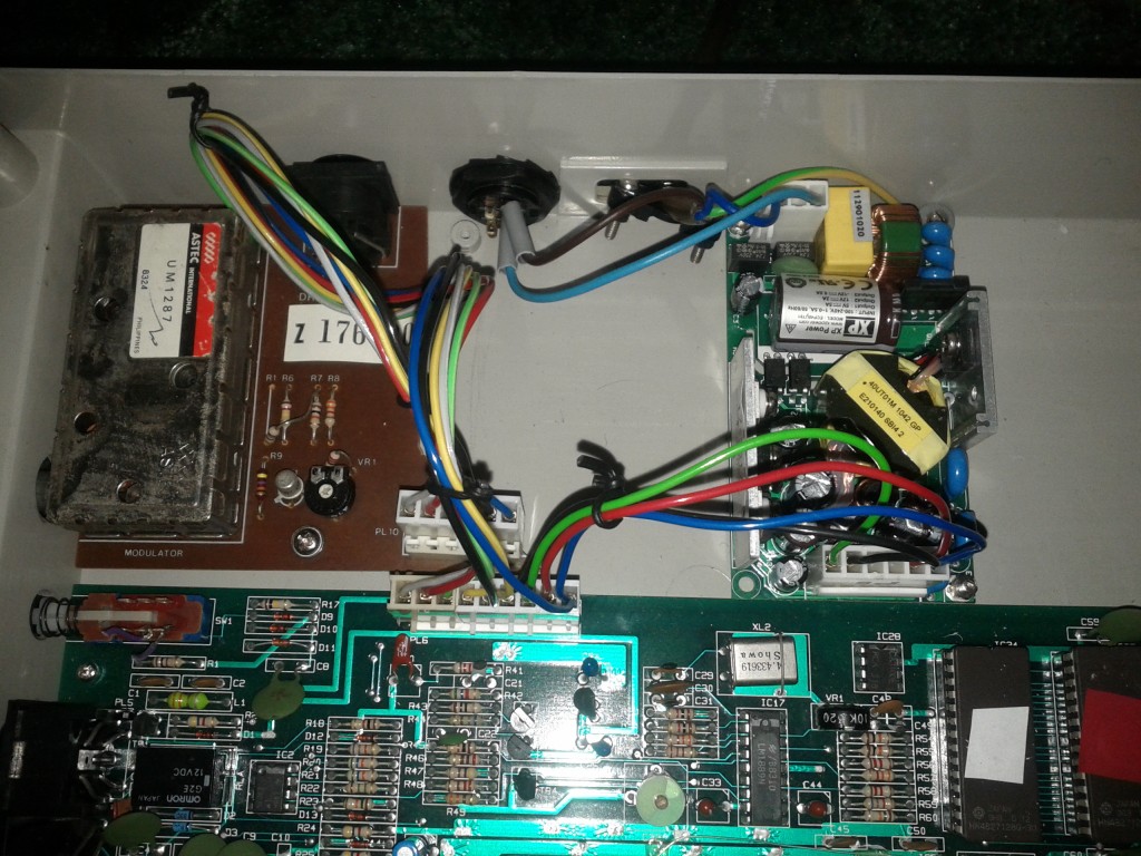

I've modded (upgraded?) all of the power supplies on my Dragon's by replacing the internal regulator board with a small switch mode PSU (which generally are in the same price bracket as the £40 you'd pay for a new transformer). Advantage is that it gives cleaner supply rails plus has a bit more juice available for running additional disk controllers/other hardware etc.

fridgemagnet
Posts: 97
Joined: Mon Nov 24, 2014 8:33 pm
Re: Dragon transformer
Post by fridgemagnet »
For those doubting Tormod's out there...
That is this little beast in a D64:
http://uk.farnell.com/webapp/wcs/stores ... reId=10151
I filed out the hole which housed the original switch and fitted a spare rocker I had on the mains side.
However Tormod is correct, for a D32 the -5V rail is the issue and these aren't so readily available at least at the same price. In the end, I did pay a bit more & fitted one of these:
Ultimately a bit of a trade off between making up a convertor yourself or just paying a bit more, in this instance I did the latter.
NB: Watch out for the prices on Farnell's site as they don't include VAT!
