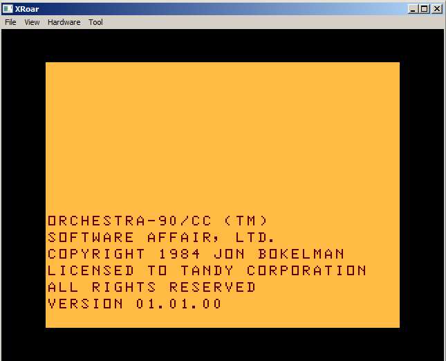

Hi all - I noticed a (very expensive) Orchestra-90 CC cartridge go by recently on eBay, and was quite intrigued by it! I note that Xroar has support for this cartridge, and Prime was helpful enough to post the firmware to the Facebook group (I've since found it in the archive - doh!).
So, I'm trying to get this to work, and I've run the following:
xroar -machine-cart orch90 -cart-rom <path_to_downloaded_rom>
The Orchestra manual suggests I should find myself running their software, but I'm still at an OK prompt. What have I missed? Thanks in advance!

I couldn't resist and tried on XRoar with this bat file
cd..
copy ..\XRoar\ROMs\d64rom1.rom d64_1.rom
copy ..\XRoar\ROMs\d64rom2.rom d64_2.rom
xroar -machine dragon64 -extbas d64_1.rom -altbas d64_2.rom -machine-cart orch90 -force-crc-match -tape-fast -joy-left 0,0:1:0 -kbd-translate -lp-file ..\XRoar\sortida.txt
del *.dgn
del *.rom
It starts but does nothing. Then I entered EXEC&HC002 and appeared this screen but the programs hangs ... or waits for a key that I have not yest preseed!
will make some more tests ... but the soft in the ROM is for the CoCo so there could be problems with ROM calls (?)
Re: Orchestra-90 CC
Posted: Thu Sep 10, 2015 6:04 pm
by pser1
got it working!
you must enter
EXEC&HC000 instead
The be sure that XRoar is emulating the CoCo Keyboard (or you will be fooled)
Select: Hardware / Keyboard Map / CoCo layout
Then press S, enter and wait for a while
Finally press P and enter to listen to the WillTell overture

I didn't look at the two first bytes on the cartridge image.
This one has no 'mark' to ask for auto-starting. Basic looks at this 2 bytes and if there is a "DK" then calls &HC002 ant there you go.
In this case the program begins right in the first byte, so &HC000 must be called instead.
Hope you enjoy it.

Pere - that worked perfectly!
Just to summarise, I did the following:
xroar -machine-cart orch90 -cart-rom <path_to_downloaded_orchestra_rom>
(my Xroar picks up the D32 rom by default)
Then I did an EXEC&HC000 in Xroar.
Don't forget to set the Coco keyboard map (I did this through the GUI).
Hit S and return (wait 10 secs)
P and return
And then sit back! In stereo, it's actually rather impressive.
