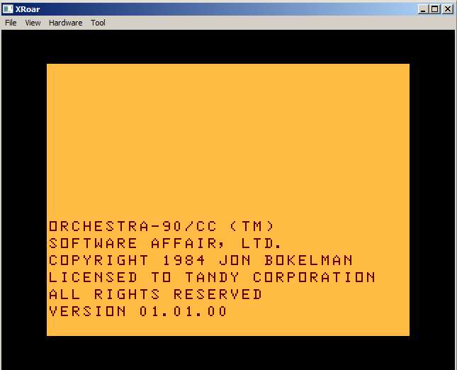

It starts but does nothing. Then I entered EXEC&HC002 and appeared this screen but the programs hangs ... or waits for a key that I have not yest preseed!

you must enter
EXEC&HC000 instead
The be sure that XRoar is emulating the CoCo Keyboard (or you will be fooled)
Select: Hardware / Keyboard Map / CoCo layout
Then press S, enter and wait for a while
Finally press P and enter to listen to the WillTell overture
