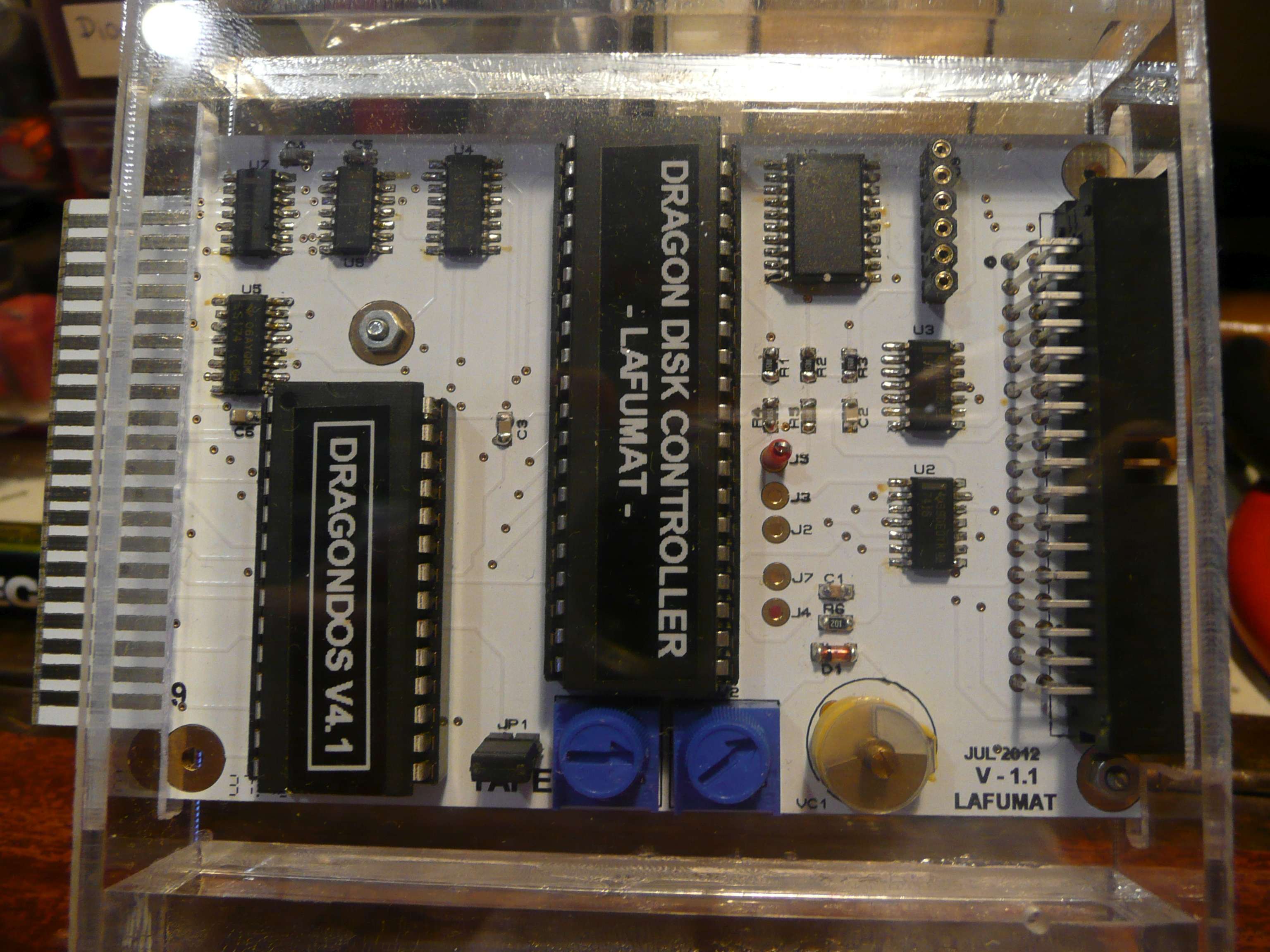

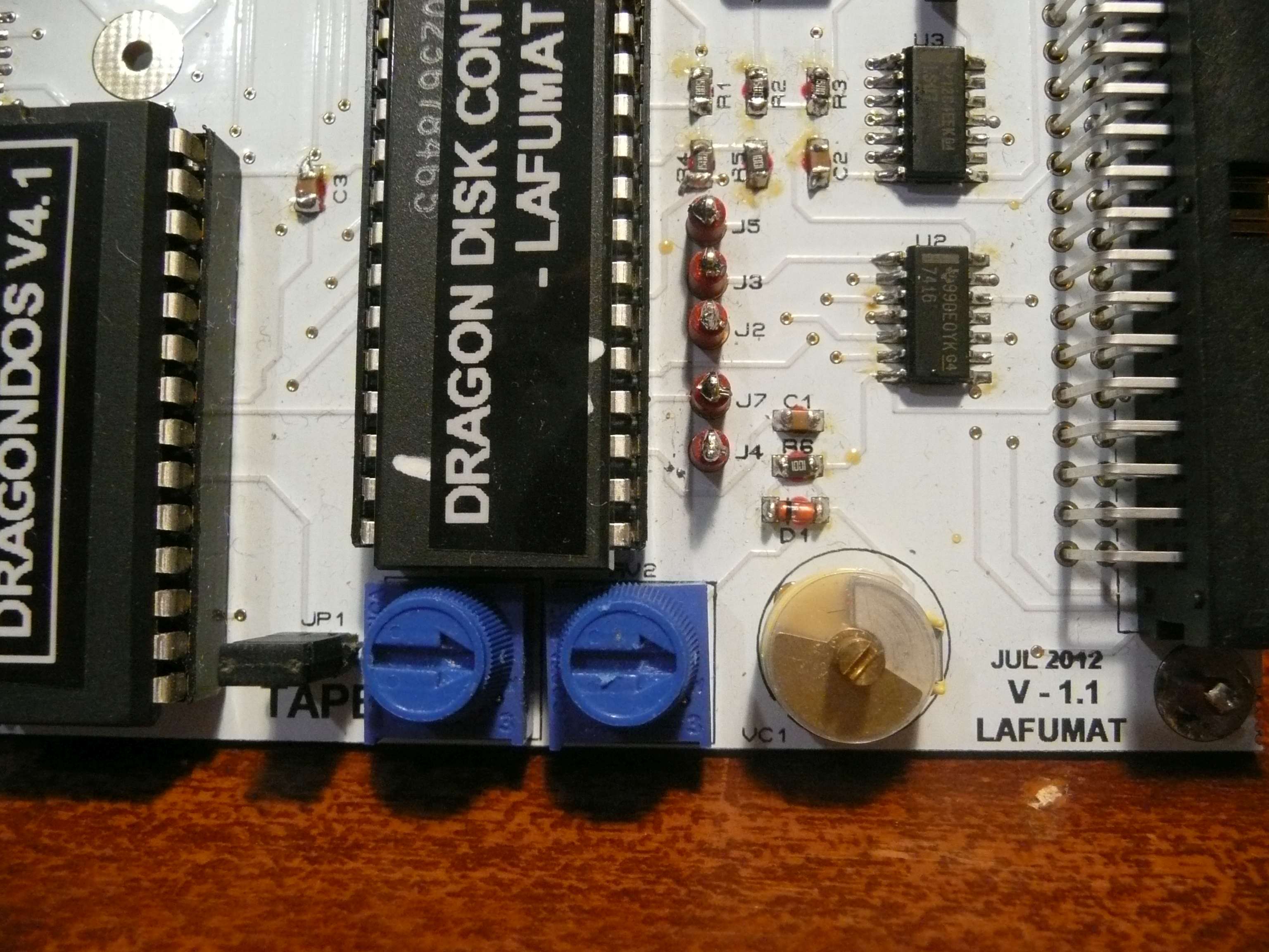

Posts: 1904
Re: I got the HxC SD Card Floppy Emulator today
HI,
I remember that the two pots don't help solving these two errors.
Only with the adjustable capacitor you will be able to find a zone that works properly.
I am attaching here two images.
One of the controller I am using daily in my working set, and another of another controller used when testing other Dragons
Ps. You better download the images to have a look at the position of pots and trimmer
My standard set has this controller with two 3,5" floppies
Stig
Posts: 74
Joined: Mon Mar 17, 2014 4:54 pm
Post by Stig »
Thank you very much Pere !
That helped me to get it working ! I set the pots and capacitor to match that of your first picture and have now got it working :)
Much appreciated
