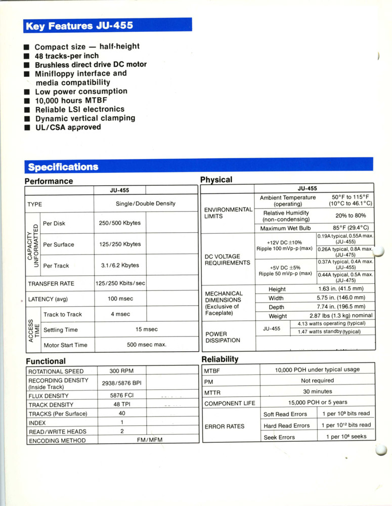

What I do have is a 5.25 floppy (Panasonic JU-455-5CGN), that I believe is a SS/DD drive.
Here are the specs:
I also have a nice external enclosure with power supply for it.
Will it be possible, if I get the right flat cable, to use this drive with the DragonDOS controller?

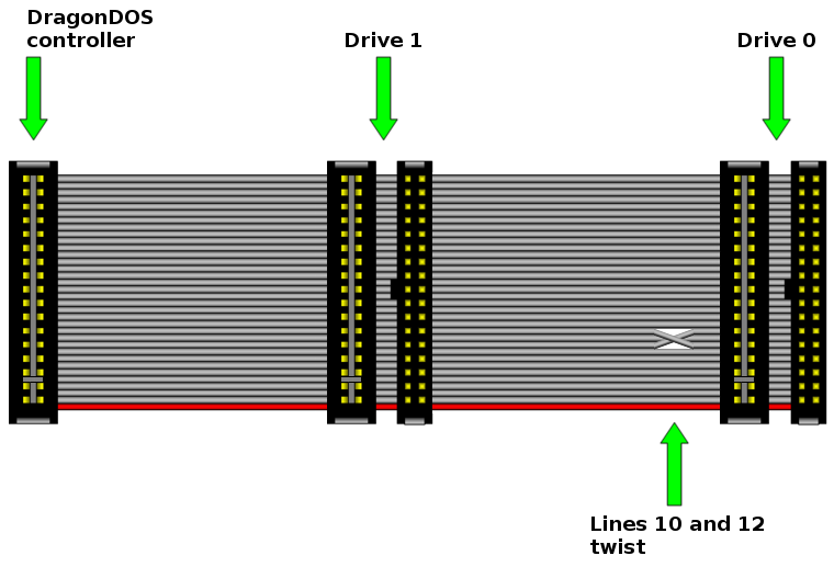

Posted: Wed Apr 01, 2015 9:28 am
Hi Tom!
Making the cable you need should be quite easy. You need two standard PC floppy cables (the ones with connectors for 5.25" and 3.5" drives).
- Open the end edge connector and revert the cable twist. Then you have to twist cables 10 and 12 (Need to confirm this later tonight), and put the connector back.
- Take one edge connector from the second cable and put it at the beginning of the cable.
That way you can connect the cable to the original DragonDOS controller or a new clone controller, and you can use it for 5.25" and 3.5" drives. The twisted end will be Drive 1, and the non twisted one Drive 2.
I'll make some pictures of my cable tonight for your reference.
You should also take into account that you may need to recalibrate your controller, as drives with slight different speeds may not be able to work properly.
The cable is intented to be used with unmodified PC drives, but you can use it with a standard Dragon disk drive by attaching it to the non-twisted connector.

Re: 5.25 floppy question
Posted: Sun Apr 05, 2015 10:31 pm
Hi Tom!
Sorry for the delay! I made a diagram based on the cable I made, so feel free to try it and share your results.
As my cable is exactly like that, but without the 5.25" connectors for the drives, it should work right away, but I prefer to have some confirmation before adding it to the wiki DIY section.
