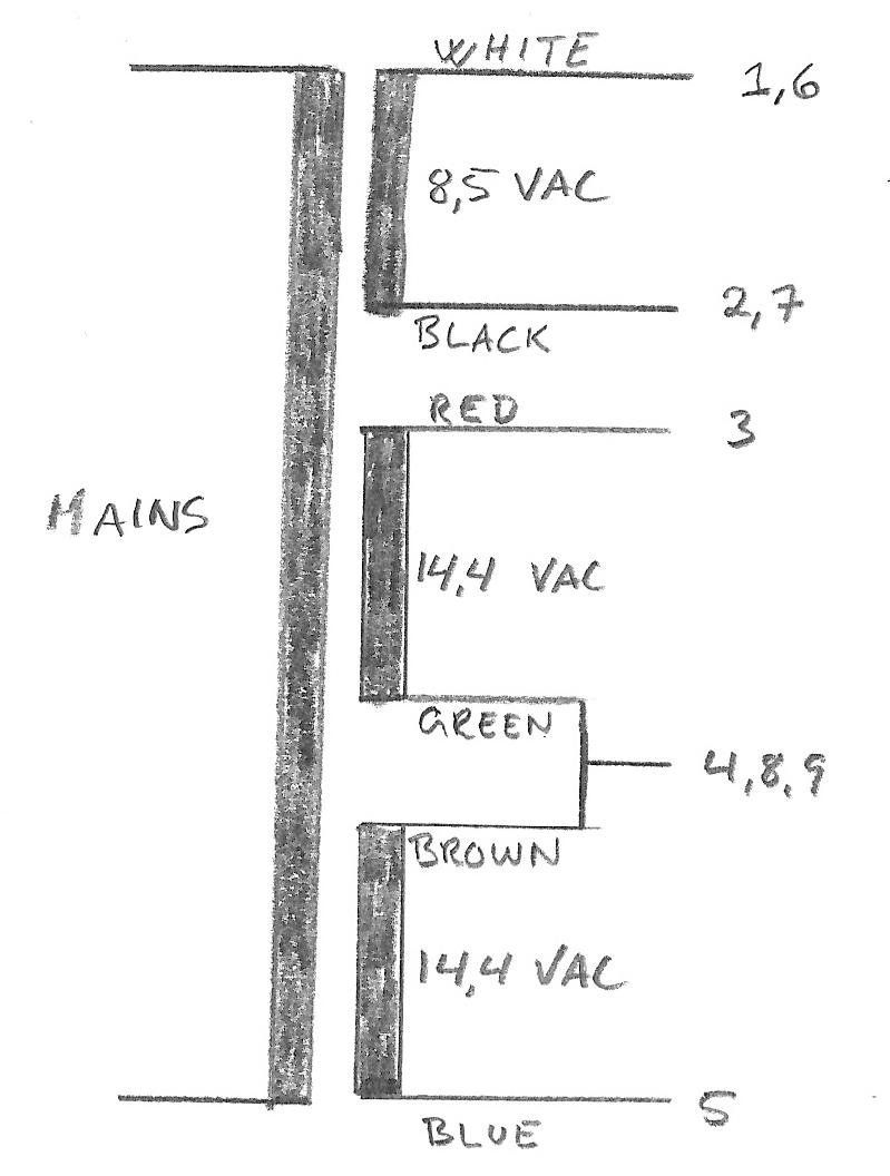

Yep, I had to "improvise" a power supply a while back when my real PSU was lost (now recovered!). I ended up building a PSU from scratch rather than using a standard PC PSU. I can dig up the part list and create some schematics if there is an interest. The Dragon PSU is quite simple.

Please upload those schematics! I have a friend with a Dragon 64 and no PSU and that will help for sure.

The Dragon PSU is basically a transformer providing 1 x 8,5 VAC and 2 x 14 VAC output. This is a fairly common transformer and easy to come by.
I buy my parts from ELFA. The parts from the ELFA catalogue are:
  • Toroid transformer 55 VA, 8,5 VAC + 2 x 14,4 VAC (part no 56-109-10)
  • 9 way female D-Sub connector (part no 44-160-54)
  • 9 way D-Sub plastic hood (part no 44-085-06)
The attached diagram shows the wiring from the transformer to the D-Sub. The transformer colour coding can be different for different transformers. D-Sub connectors always have tiny numbers next to the pins so there is little change of getting that part wrong.
