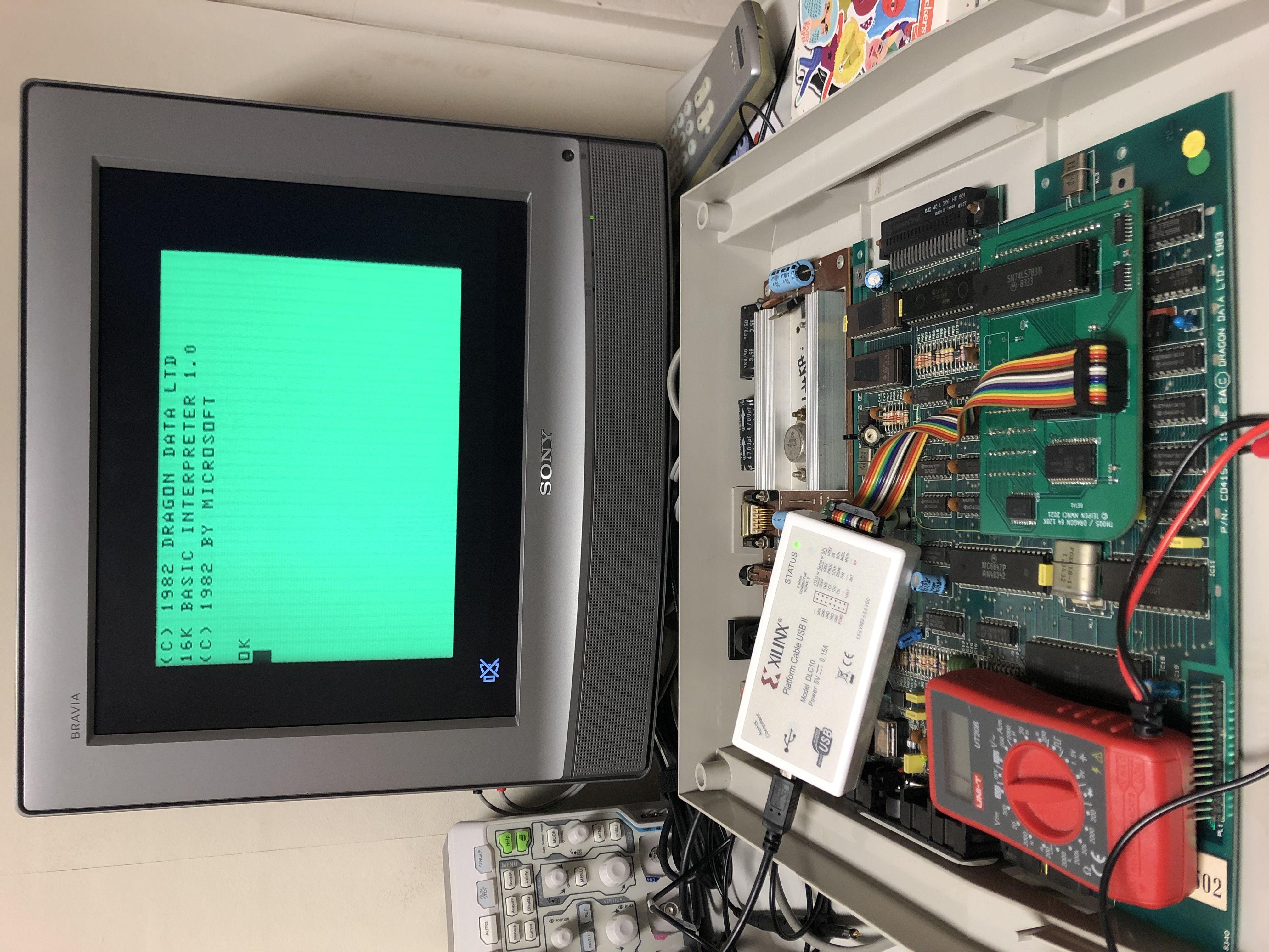

The "only" problem with that (only 128K) board is it doesn't work in high speed mode. As "someone" pointed out to me, I oops missed a CPU latch. Ah well, that's what prototypes are for. Working on a 512K internal version...
