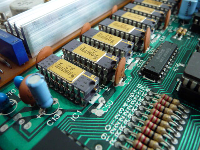

I have got a few more pictures, these are from a Dragon 32 which I will add to the database once I have carried out the speed POKE.
Thank you Zephyr for the information that a couple of your D32's have Reg 3 bolted down, the only one I have seen was in a TANO. I will post my next question on this in a new topic.

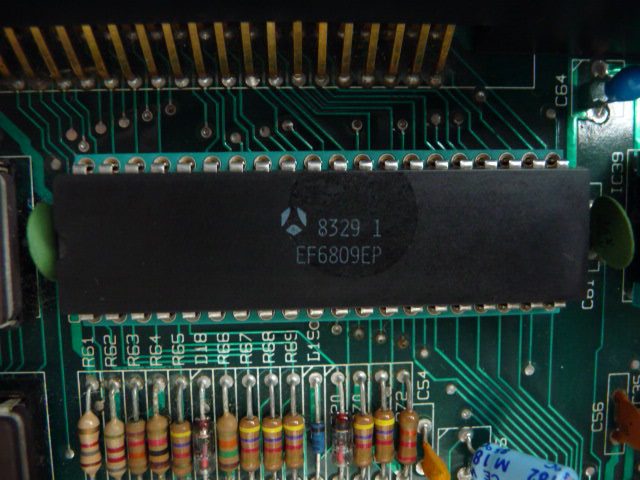

Thomson 6809
Thomson 6809
Re: Dragon survey, what to ask for?
Fantastic! :D The 'Siemens' board, with its 8 Siemens HYB-4232 (double 16K) RAM chips. And, a picture of the Thomson EF6809E processor. 8-)
Here's the data sheet...

I think these are basically the same as the boards that were fitted with OKI chips. Any chance of a picture of the whole board?
Edit: It would be nice to have good pictures of all four boards.

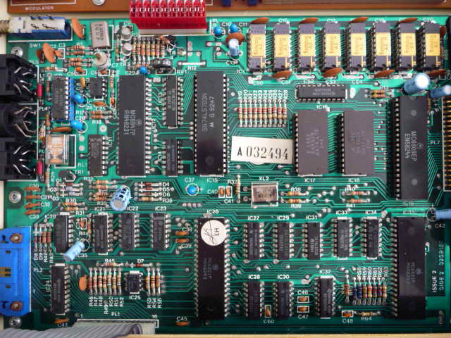

Here is the full 'Siemens' main board
Thanks! :) This picture now shows a Motorola MC6809E processor rather than the Thomson above. Have you got two Dragon 32's with 'Siemens' boards fitted?
Edit: Looks like I was wrong about these being the same as the OKI type boards. Still issue 2, but I can see that it has some of the mods that were present on the later 16x16 type boards..
