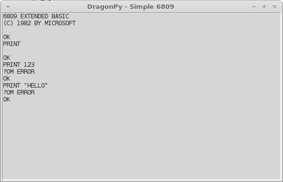

Re: Dragon emulator written in Python ???
I'm done many updates and used the new 6809 opcode data, see: viewtopic.php?f=8&t=4388#p9703
Now the Simple6809 works a little bit more: I can input some code... but get allways "OM ERROR" Back.
Think there is a bug in carry flag, because of this:
debug output:
EDIT: Dragon 32 ROM with XRoar trace compare differends after round 33.400 CPU cycles here:
Think also because of wrong CC values.
Simple 6809 looks now like this:
* CHECK TO SEE IF THERE IS ROOM TO STORE 2*ACCB
* BYTES IN FREE RAM - OM ERROR IF NOT
def0 4f LAC33 CLRA * ACCD CONTAINS NUMBER OF EXTRA
def1 58 ASLB * BYTES TO PUT ON STACK
def2 d3 1f ADDD 001f(ARYEND) END OF PROGRAM AND VARIABLES
def4 c3 00 3a LAC37 ADDD #003a(STKBUF) ADD STACK BUFFER - ROOM FOR STACK?
def7 25 08 BCS LAC44 BRANCH IF GREATER THAN $FFFF
def9 10 df 17 STS 0017(BOTSTK) CURRENT NEW BOTTOM OF STACK STACK POINTER
defc 10 93 17 CMPD 0017(BOTSTK) ARE WE GOING TO BE BELOW STACK?
deff 25 ee BCS deef(LAC32) YES - NO ERROR
df01 c6 0c LAC44 LDB #6*2 OUT OF MEMORY ERRORCode: Select all
def2| (30188) read byte $c3 from $def4
read pc byte: $c3 from $def4
get m with get_m_immediate_word
def4| (30189) read byte $3a from $def6
def4| (30190) read byte $0 from $def5
read pc word: $003a from $def5
get_m_immediate_word(): $3a from $def5
def4| instruction_ADD16(m=$3a opcode=$c3 register=D=021c)
$def7 c3 3a ADD16 D: 540 + 58 = 598 (signed: 598)
def4| c3 ADDD D=021c m:3a cc=50 a=02 b=56 dp=00 x=00f4 y=dd35 u=00ff s=0147 | .F.I....
def4| (30195) read byte $25 from $def7
read pc byte: $25 from $def7
get ea with get_ea_relative
def7| (30196) read byte $8 from $def8
read pc byte: $08 from $def8
get_ea_relative(): ea = $def9 + 8 = $df01 | $df01: $df01 - OUT OF MEMORY ERROR
def7| instruction_BLO(ea=$df01 opcode=$25)
$def9 BLO/BCS/LBLO/LBCS: don't branch to $df01, because C==0 | $df01: $df01 - OUT OF MEMORY ERROR
def7| 25 BLO ea:df01 cc=50 a=02 b=56 dp=00 x=00f4 y=dd35 u=00ff s=0147 | .F.I....
new PC: def7 -> $def9 | $def9: $def9 - CURRENT NEW BOTTOM OF STACK STACK POINTERCode: Select all
b3d3| 30 LEAX X=0601 ea:0602 cc=50 a=00 b=60 dp=00 x=0602 y=b39b u=0000 s=03d7 | .F.I....
b3d3| 3001 LEAX 1,X cc=50 a=00 b=60 dp=00 x=0602 y=b39b u=0000 s=03d7 | .F.I....
b3d5| 63 COM ea:0603 m:10 cc=59 a=00 b=60 dp=00 x=0602 y=b39b u=0000 s=03d7 | .F.IN..C
b3d5| 6301 COM 1,X cc=59 a=00 b=60 dp=00 x=0602 y=b39b u=0000 s=03d7 | .F.IN..C
b3d8| f1 CMPB B=60 m:dd cc=53 a=00 b=60 dp=00 x=0602 y=b39b u=0000 s=03d7 | .F.I..VC
b3d7| 20f1 BRA $b3ca cc=59 a=00 b=60 dp=00 x=0602 y=b39b u=0000 s=03d7 | .F.IN..C
trace: b3d7| 20f1 BRA $b3ca cc=59 a=00 b=60 dp=00 x=0602 y=b39b u=0000 s=03d7 | .F.IN..C
own..: b3d8| f1 CMPB B=60 m:dd cc=53 a=00 b=60 dp=00 x=0602 y=b39b u=0000 s=03d7 | .F.I..VC
b3d8|Error in CPU cycles: 33439
address ('b3d8' != 'b3d7') not the same as trace reference!
mnemonic ('CMPB' != 'BRA') not the same as trace reference!Simple 6809 looks now like this:
- Simple6809_TK_02.PNG (14.3 KiB) Viewed 25387 times

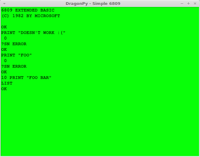

After a few updates i get no OM ERROR anymore. But not really working. Often a SN ERROR or something else.
I adapted now the XRoar CC routines with: https://github.com/jedie/DragonPy/commi ... 77742423c2
OM ERROR is away. But unuseable anyway
But maybe my python translation it's not enough.
- Simple6809_TK_03.PNG (19.85 KiB) Viewed 25368 times
