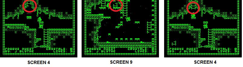

In screen 4 is a broken ladder (left picture).
You have to pick up the ladder object in screen 9 (middle picture).
Use the ladder object in screen 4 and the ladder is repaired (right picture).
If you are not using Adventuremode, the ladder is broken again if you leave and re-enter screen 4.
With Adventuremode, the ladder is still repaired if you leave and re-enter screen 4.
The ladder is repaired with 4 PUTBLOCK commands.
In Adventuremode, the screen number, y-pos, x-pos and block number of a PUTBLOCK command, given in the EVENT code, are stored in a list.
When a screen is drawn, this list is checked and blocks with this screen number are also drawn on the screen.
You need this because you have to climb the ladder several times.
There are more of these constructions in the game.

Hi Kees,
that's very tricky!
Alright, once understood I find it easy to add to the engine.
Hopefully this will be the last one for the FOGGY, despite we are still testing the colour capability
for block-objects-sprites on PMode3
Thanks a lot
