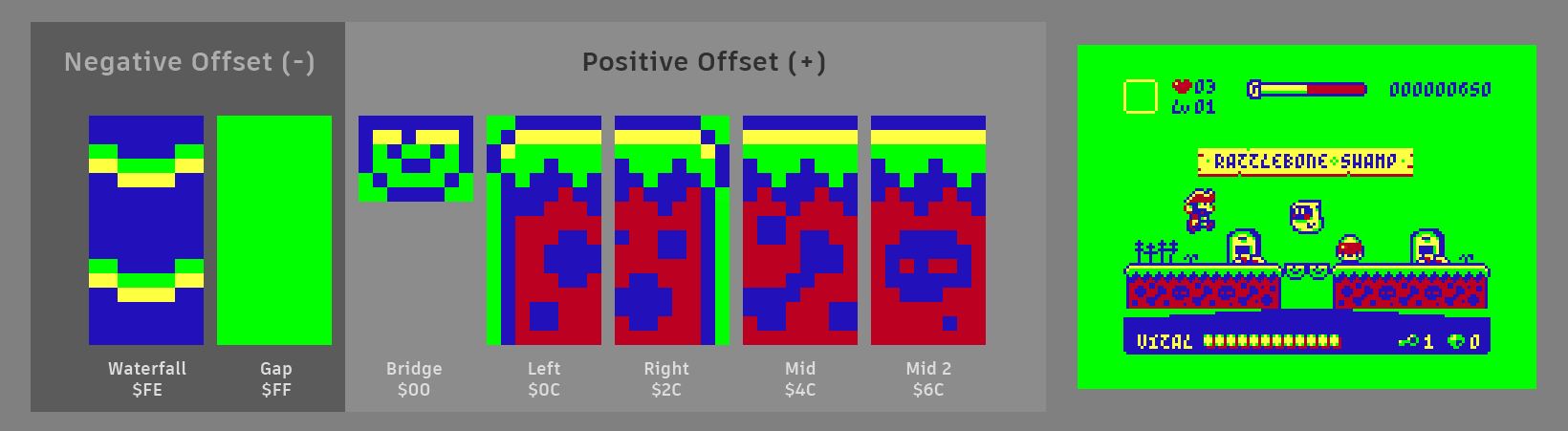

As work on the game isn't too visual at the moment I thought instead I'd describe briefly how I'm encoding platform data for each screen. Naturally, efficient data is as important as efficient code. With this in mind, I'm encoding platforms as a series of signed 8-bit offsets which index the tile graphics in memory. This not only simplifies calculations when rendering but can also optimise tasks such as collision. Tiles which I've designated as solid all have positive offsets while tiles which the player can fall through have negative offsets. So just from loading any tile ID I can immediately either BPL or BMI (branch if plus/minus) to determine whether a tile is collidable or not. Similarly bridges are solid but can be destroyed (by bombs) so they have a zero offset and can be quickly identified using BEQ (branch if zero).
On a side note, bridges only require 12 bytes of graphics data and are rendered separately by a routine which completes the tile by jumping partway into an optimised gap tile draw routine. The same routine is also used to render blue waterfall tiles by simply loading a different value into the D register (animating wave patterns are overlayed separately). You'll also notice that the tile sequence is disjointed. The number of mid tiles varies between tile sets so positioning them at the end keeps the initial offsets consistent and the latter optional.
- Platforms.png (17.92 KiB) Viewed 29671 times

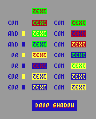

I thought I'd split my next project update into two parts and talk briefly about the game's text handling before moving onto the main update. Circe's font uses only five bytes per character so is small enough to encode text strings as a series of 8-bit offsets into the font graphics data. One byte can index a range of 52 characters or 10 digits, 26 letters and 16 extra characters. This approach simplifies text rendering but also sidesteps the added awkwardness of graphics which aren't power of two in size.
When calling the text rendering routine I pass it the number of characters I wish to print rather than relying on an end of string marker. Being able to print a varying number of characters from any point in a string comes in handy for all sorts of uses including scrolling messages, animating UI gauges and applications I'll discuss in the following update. One more point of interest I'll mention is that the text renderer ignores leading zeroes by continually looping (BEQ) until it loads a non-zero character offset or only one character remains to be printed. This is useful for printing player scores etc. however if preferred the text renderer can be called a few instructions further on, bypassing this behaviour altogether.
When a character is rendered I use the screen offsets 0, -32, -64, -96 and -128 to keep the index addressing range 8-bit. Text is stored as red pixels (%11) on a green background (%00) but other colour combinations are achievable by flipping bits using AND, OR, EOR and COM (see truth table below). The text renderer includes strategic NOP instructions which can be overwritten to alter the output to any desired ink/paper combination. As well as the main text renderer I also use a dedicated rendering routine for a slightly more complex drop shadow effect.
The next update will be a bit more interesting but it's useful to know how text is handled if you're following along with the project.
- Text.png (2.61 KiB) Viewed 29055 times

That's a neat way of colouring the text. Always 4 cycles if you use OR #0 as a NOP.
And there's me thinking my own method at 6 cycles was being clever
Re: Project 2
Great suggestion Stew. That's going in.
