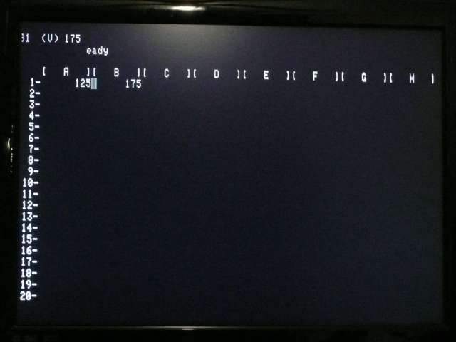

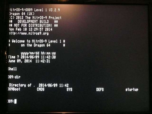

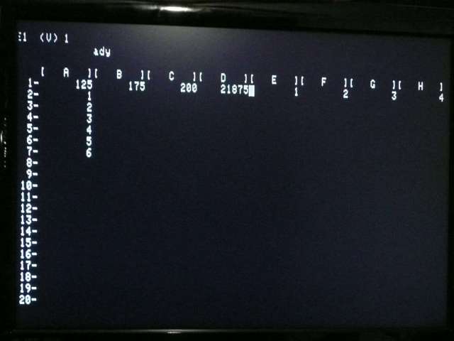

Hello Ken,
I have had the time to transfer the NitrOS-9 disk that you prepared for me (DOS bootable) and tested ...
I attach here some screenshots.
First to mention is that one more time I lose a char on the left margin and possibly three on the right one.
How could I change this settings in NitrOS-9?
Second thing is that on Stylograph the literal Value appears with one or two lost chars at the beginning (2nd and 3rd shots) ... any idea?

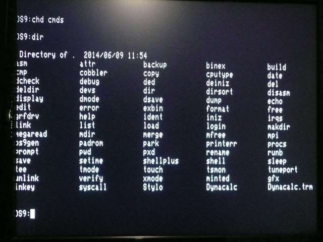

I haven't found the old GO40, GO51 commands. Have they been deleted because of the WordPak80x24 doesn't need them?

- 1st shot
- 01 - NitrOS-9 start screen.jpg (52.72 KiB) Viewed 9079 times
- 2nd one
- 02 - Dynacalc shot1.jpg (41.66 KiB) Viewed 9079 times
- 3rd one
- 03 - Dynacalc shot2.jpg (43.27 KiB) Viewed 9079 times
- 4th shot
- 04 - CMDS dir.jpg (58.62 KiB) Viewed 9079 times
- 5th one
- 05 - Stylograph menu.jpg (61.78 KiB) Viewed 9079 times
Hi pere,
Here are the NitrOS9 wordpak drivers with patches to compensate for overscan.
These drivers default to my own margins (3 on the left, 4 on the right), but you can easily adjust them as needed.
The obvious changes are in CoWP (aka Co80) and term_80.
I have patched the CoWP code and added equs for OSCAN (=left margin) and LASTC (= last visible column 0-79)
In term_80 you need to adjust szx and szy for the number of visible columns and rows.
What wasn't so obvious is that the screen dimensions are also hard coded into vtio (not so elegant I'd say).
So you also need to change the following line to match your actual visible screen size:
I'm aware of the bug in Dynacalc that causes the first letter of the status line (Ready) to disappear. I haven't investigated this but it does go back to Luis's driver as can be seen in this video: https://www.youtube.com/watch?v=Wli_mhhT4EE
GO40, GO51 were part of Dragon Data's customized OS9 release and do not exist in Tandy OS9 or NitrOS9.
I think these commands patch in memory the Dragon's video driver (KBVDIO).
In any case, the wordpak nitros9 disk doesn't load any video driver for the VDG, thus freeing some memory that is badly needed under OS9.
Having said that, the modularity of OS9 makes it quite easy (memory issues aside) to have a dual display system (ie /term and /term80)
