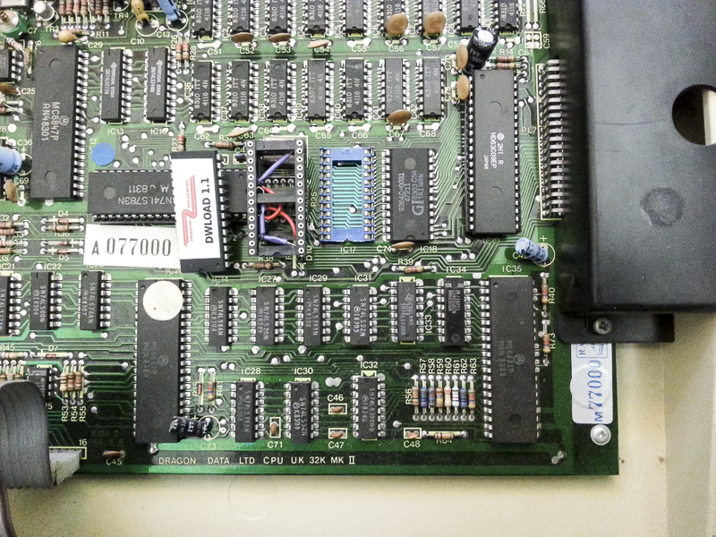

Before i do something wrong. This is the correct rotation, isn't it?
All noses down, right?

Jedie, yes, the "U"-shaped notch of the EPROM, adapter, and socket should point in the same direction. And yes, you need to mount something (just any file) in drive 0, as sorchard found out for us in the previous posts. Sounds like you got it all working.
