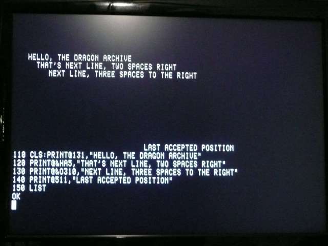

I have tested from disc in my Dragon64 and it works perfect. I attach a screenshot with the results and the listing of the program that just uses PRINT@
I have saved it to Audacity: CSAVEM"WP23D64",&H7D00,&H7F70,&H7D04
and then I have loaded it to XRoar and saved it to the VDK image with that new name.
Later I have saved it from XRoar to CAS and WAV files wich are in the attached zip together with the VDK image.
Hope it works good for you too.

I have read your message again and I have detected that you write the command PRINT then a space and finally the @ sign.
If this is the case, then it will NOT work!
I had always written PRINT@ together when I used to program many years ago ...
I did rewrite the PRINT hook so that it verifies first that the token is $87 (PRINT) and then it verifies that NEXT char is @, in this case it sets the flag else it does nothing, so the text will be displayed on the next line.
Just confirm this point and if so, I will add a bit of code so that it will skip the spaces between PRINT and @

Great observation, pere!pser1 wrote:I have read your message again and I have detected that you write the command PRINT then a space and finally the @ sign.
Old habits die hard
The code you uploaded yesterday works great without the space!
I am testing on a Dragon 64, using hdbdos and drivewire.
It would be a good idea to add code to ignore spaces to ensure compatibility with existing basic programs.
I'd be happy to continue testing.

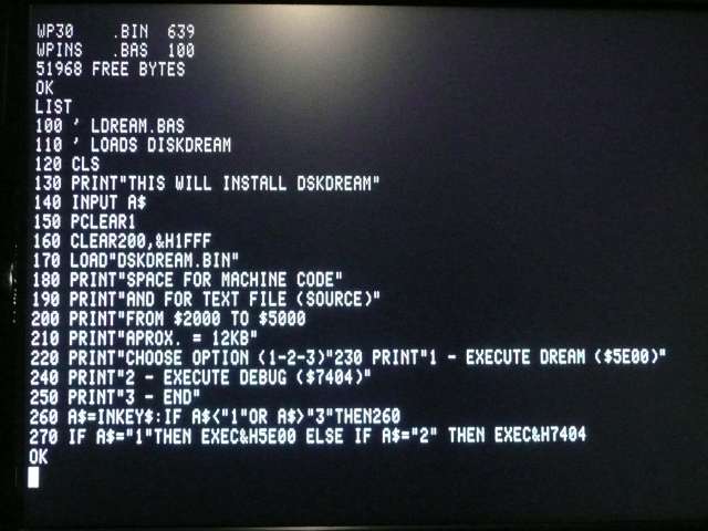

I have detected an annoying "Basic - Dragon 32 char screen" characteristic.
It turns out that when you LIST a Basic Program using the WordPak80x24 you will find, sometimes, that a line has been concatenated to the prior one instead being in the next line!
I attach a screenshot, you will see that line 230 is added to the line 220 which is exactly 32 chars long.
I didn't understand why this could happen ... untill, by hazard, I saw that every basic line that is exactly 32 chars length, is printed on screen by the basic but without any forthcoming ENTER, because it has changed of row, gracefully!
Unfortunately, we have plenty of space after the 32nd column and so next line will appear next to the end of the "odd 32 char length" line.
I think that it is going to be difficult to detect that case because we are receiving individual chars, so this problem will requiere some time to think of a solution.
If you have any idea to solve this problem, you are welcome!

An interesting problem. I assume your driver only intercepts OUTCHR and you don't want to intercept and duplicate the LIST command. The LIST command runs from $8EAA. The decision to whether print CR is done in the routine called at $90A5. But your hook is never called from within there when this issue appears (the opposite problem would have been easier).pser1 wrote:Unfortunately, we have plenty of space after the 32nd column and so next line will appear next to the end of the "odd 32 char length" line.
I'd suggest you check if CR was just printed when the line number is printed. If not, send a CR to the CRT9128.
So first of all your driver should keep track of the last printed character. The LIST code calls $957A (print D in decimal) to print the line number, which jumps to $90E5 to print the resulting string, which finally calls OUTCHR at $B54A. You should check the return addresses on the stack to see if you are in this situation, and then send a CR if a CR was not the last character printed. And you need to check that you are at the first digit of the line number string. For this, try comparing B (the string index of the string print routine) with the contents of $56 (BASIC string length).
For sake of performance you may want to check first that a decimal digit is printed before looking at the stack etc.
EDIT: I had originally made it more complicated than it had to be. The line number is printed as one string, not digit by digit. The stack should contain $B54D, $90F3, $8EF1.
EDIT2: It is more complicated but different: Need to check we're at the beginning of the string.
