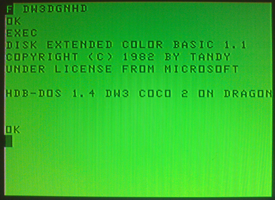

I tried yesterday with DriveWire 3, hdbboot.dsk and the small "8 seconds" wav loader. And you know what ?
I WORKED PERFECTLY !!!!! :P :P :P :P

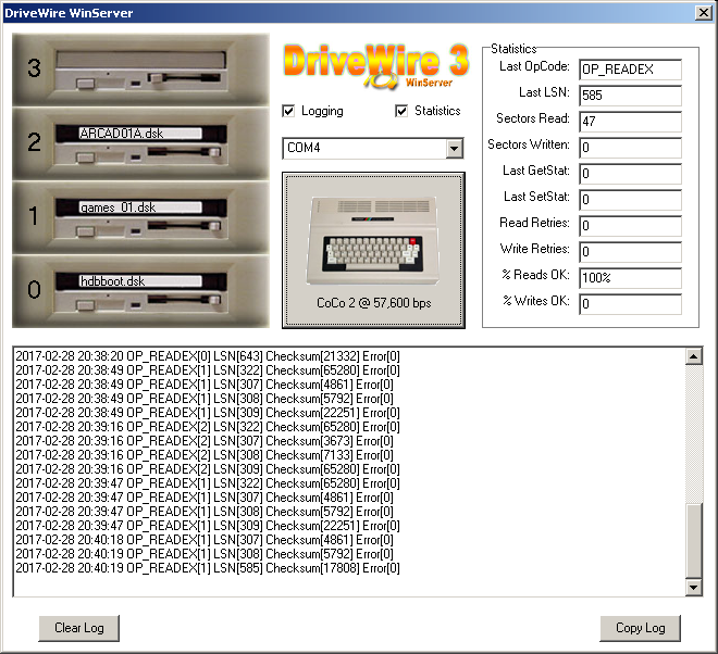

Here is my configuration on DW 3 :
DriveWire 3 configuration
First boot : got the DOS shell and the welcome message. yeahhh !!!
First boot. Yeah !!!

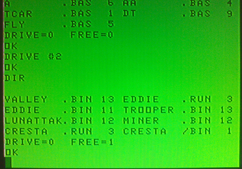

Switched between the drives with #1 and #2. Got the good results with a DIR command :
DIR results
DIR results

Looking at the images you have uploaded, I see that the DIRectory
of the DSK shows the data in TANDY format, I mean it tells the number
of granules used by each file and at the end we see the free granules.
This is not the same format as Dragon Data DOS use, so it is not clear
to me if you would be able to use our VDK with this configuration.
To load programs in a Tandy environment, you should issue:
LOADM "FILENAME" and EXEC (if it is a BINary one)
LOAD"FILENAM" and RUN (if it is a BASic one, the .RUN seem to be Basic to me)
