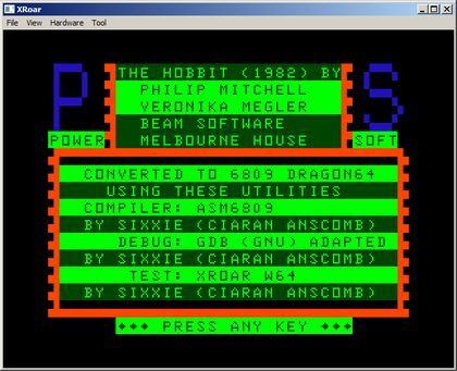

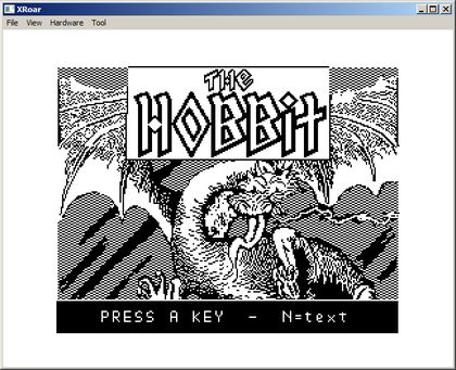

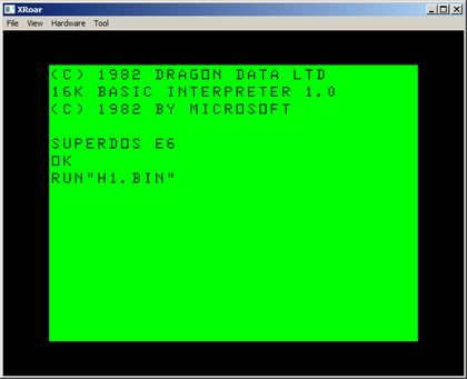

Posts: 1899
Re: XRoar, GDB
Hi Ciaran,
I don't know if you have had the time to test the Hobbit on your machine
with the SuperDOS E6
I have copied some screenshots of the game ...
Posts: 1485
Re: XRoar, GDB
I did, and it looks brilliant :) Thanks for the E6 support, I'll be trying that on my real machine when I eventually get space to pull the beastery down from the loft.
