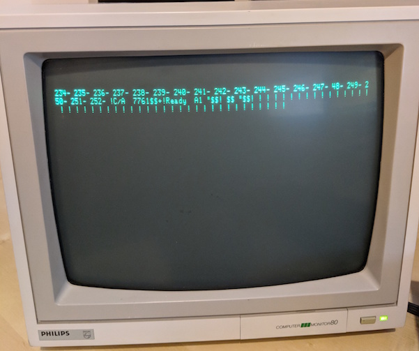

Hi Ken! Thanks for the tip. However, when I run it, I get this:
To me it looks like it's trying to use different screen control codes - is this down to the display driver?
I feel we're close now! :)
Many thanks in advance, Tony

Very likely... unfortunately...
Nitros9 control codes != DragonData Go51 ones...
I think disasm'ing this version of Dynacalc and the standard Tandy and Dragon Data ones and doing some diffs might be useful though.
Same for comparing the dynacalc term config files.

I took a look at this, and compared, among other things, the Dynacalc executable across the Dragon, Tandy and the aforementioned Nitros9 versions. All were the same! So I went back to the idea that the Dynacalc.trm file must have the parameters in it... that is after all what is claimed in the Dynacalc manual.
Tony had already searched for 51 ($33) values and tried changing any that weren't in string resource sections of the .trm file. So I reasoned that the screen width must be represented 0-x, rather than 1-x. And the first candidate $32 byte at $010e, when changed to $4F (79) turned out to be the correct one!
The row count doesn't need to be changed as well as the device descriptors for serial devices have an attribute storing the 'lines per page' value, and Dynacalc reads that directly...
In terms of other control characters, the DragonPlus OS9 driver only seems to support underline, which it renders for both underline and inverse video control codes. I assume this is a hardware limitation of the DragonPlus board, so unfortunately no reverse video column / row labels, just underline.
Anyway, an 80 column DragonPlus disk for Dynacalc is attached.
