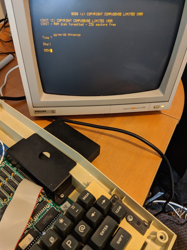

And we have OS/9 - okay, here's what I did, so I don't forget, and hopefully someone else finds it useful too.
I downloaded 'OS-9 Level 1 v1.2 (1983)(Dragon Data Ltd)[OS-9][!].zip' and 'DragonPlus OS9 Drivers (1985)(Compusense Ltd)[!][OS9].zip' from the OS/9 section of the archive.
I copied the unzipped OS/9 boot disk (OS9-SYSTEM.VDK) to OS9DPLUS.VDK, and loaded into Xroar as disk 1, set for 'write enable' and 'write back'
Loaded the Drivers disk as disk 2.
From inside OS/9 I did ...
COPY /D1/STARTUP /D0/STARTUP
COPY /D1/GO80 /DO/CMDS/GO80
(and so on for each file)
Then I quit Xroar, copied the VDK to my SDC and booted off OS9DPLUS.VDK - the machine now hangs, but that was expected - see this: http://archive.worldofdragon.org/index. ... versus_OS9.
I actually skipped a step - I didn't do the poke, but went straight to EXEC9736 - it booted again, but this time all way to G080 and a working DragonPlus (I might need to do the poke next time if I want serial access maybe?)
