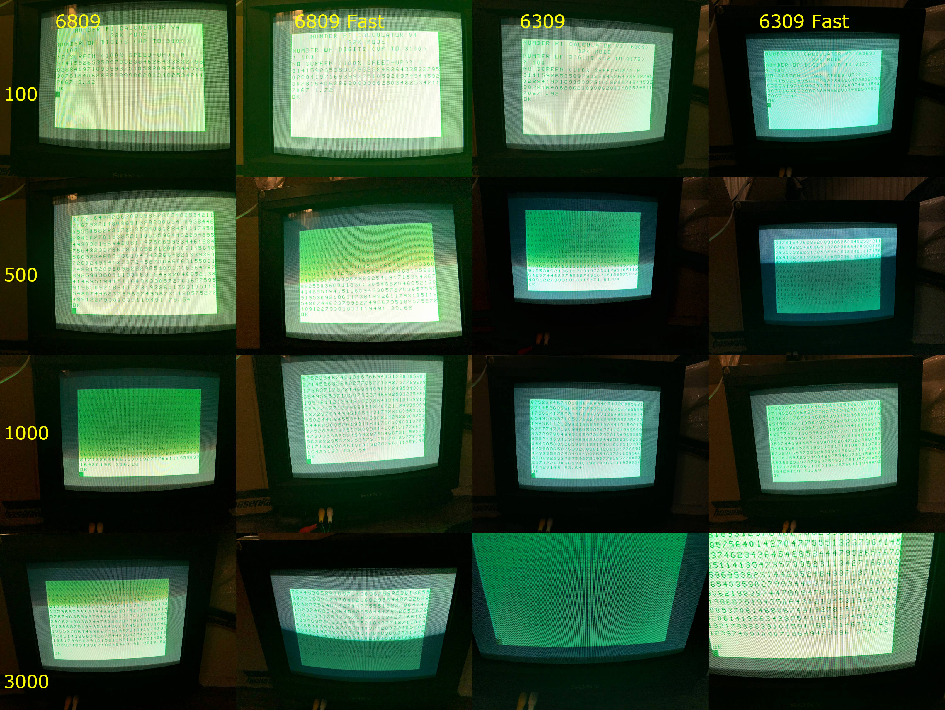

Here are the results for 3000 digits:
6809 2838.62
6809 Fast 1413.94
6309 750.82
6309 Fast 374.12
The 6309 is a beast indeed!
Glad to help if you need any more tests.

You can see a scan of my 64's board here.
The only thing I changed since I got it in 1993 is the processor, which I upgraded to a 6309.
Also, during fast mode operation, I could only see garbage on the screen and saw the result once the program finished.

@robcfg Could you check the results? If DIVQ is wrong then it just gives wrong digits. IMHO checking the last digits will be enough. For 100 digits they are 7067, for 500 - 9491, for 1000 - 0198, for 3000 - 49423196, for 3176 (it is the maximum for my 6309 program) - 07104863.

It’s a blessing I kept the pictures I took from the screen with the different results
They all match on all four configurations.
Re: A mathematical demo
So it proves that DIVQ is rather correct. IMHO It is worth to publish one of the pictures.robcfg wrote:It’s a blessing I kept the pictures I took from the screen with the different results
I made a mosaic of all the pictures.
They are not great, but you can read the numbers well
- litwr.jpg (1.13 MiB) Viewed 9827 times
