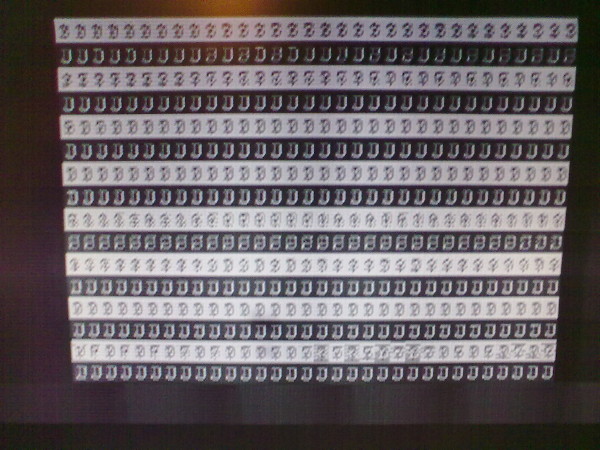

My Dragon 32 that I bought broken on eBay showed this screen pattern. I thought it was the 6847 but it turned out to be a poor -5V supply. The culprit was the capacitor C5 on the power board, the one between the R5 resistor which gets pretty warm and the row of power diodes. Make sure you get the polarity right if you replace this capacitor!
- broken-C5.jpg (98.4 KiB) Viewed 8878 times

I'm willing to give any suggestion a try so I've ordered some replacements for C5. The screen shot looks slightly different to what I'm getting but as I'm clutching at straws it cant hurt to swap it out. Ordered a replacement 7905 regulator to swap as well.tormod wrote:The culprit was the capacitor C5 on the power board, the one between the R5 resistor which gets pretty warm and the row of power diodes. Make sure you get the polarity right if you replace this capacitor!
