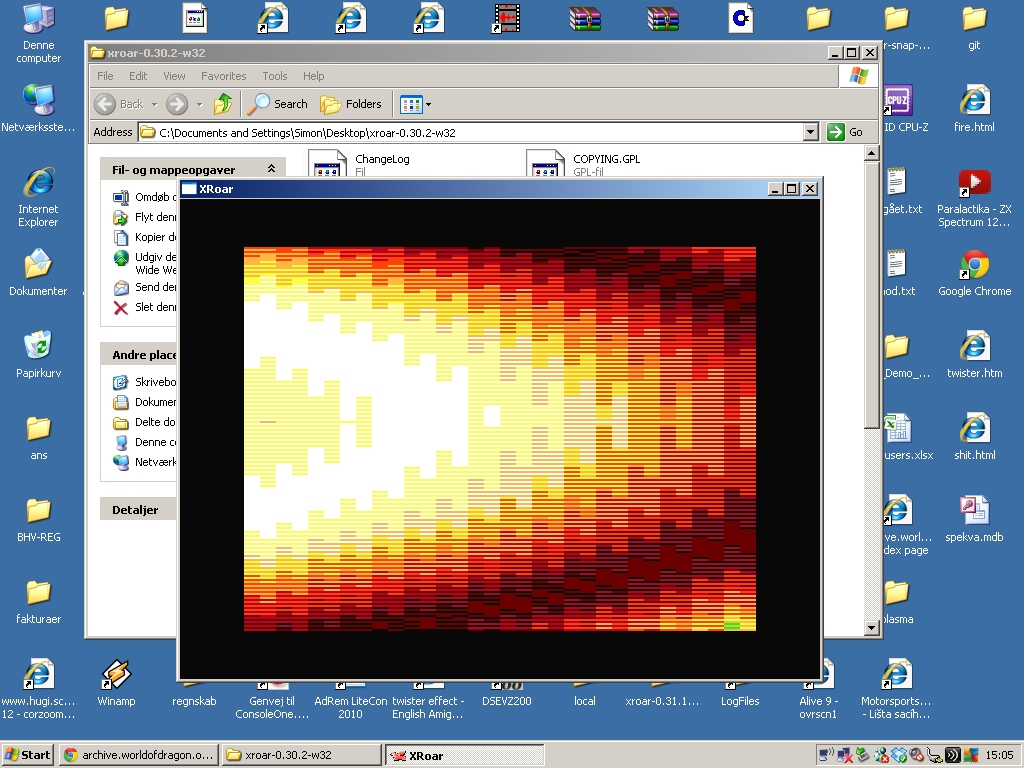

I've done some cooking of my own for even more speed
The additions in the inner loop can be removed by manipulating the table pointers before each line. The tables have to be doubled up but it's worth it for the speed boost. Just wondering where best to send the modified source as I'm not being allowed to attach files...

Something like this? http://www.6809.org.uk/tmp/plasma-new.s
Can probably do the same to the use of the Y reg (edit: done)...

That optimisation makes it fast enough to remove the "cheat" which guessed the next colour, and still complete an (interlaced) update in less than 3 frames! Nice!

Yep, that kind of thing. As you point out, the same thing can be done with the y reg to get rid of the addb #2 which in turn means the t41 line can be moved out.
Other observations:
I redeclared the pos and neg halves of each table as macros just to make it easier to specify the doubled up tables, though in a demo setting it would probably be more space efficient to generate the expanded tables on demand.
The p3/t3 bit of code at the top of y1loop can be moved outside the loop because t3 doesn't change during the loop.
The sine table amplitude can be increased to 41 without overflow.
A new table could be precalculated so that the source bytes are stored consecutively allowing two source bytes to be loaded at a time. The downside would be the animation would lose a bit of variety as a result because there are no longer any 'in-between' positions for t41 to explore.
It might also be fun to explore how well it could be made to work with a single lookup table i.e. have a precalculated table of colours that already follow a sine function. This could be made to run a lot faster.

Ah. I managed to attach a zip with the modified source. Apologies if my windows setup has mutilated the tabs and LFs!

Edit: Attached new source and binary. Experimental 50fps version.

what i will do "though" is point you all to an error that wasn't part of the original code.....
alot of ppl won't notice it as it runs fast and looks nice...
but if you study the attached file, you can see that the LSB/MSB should be swapped in certain situations.....
ok.... sixxie sorted that out.......
