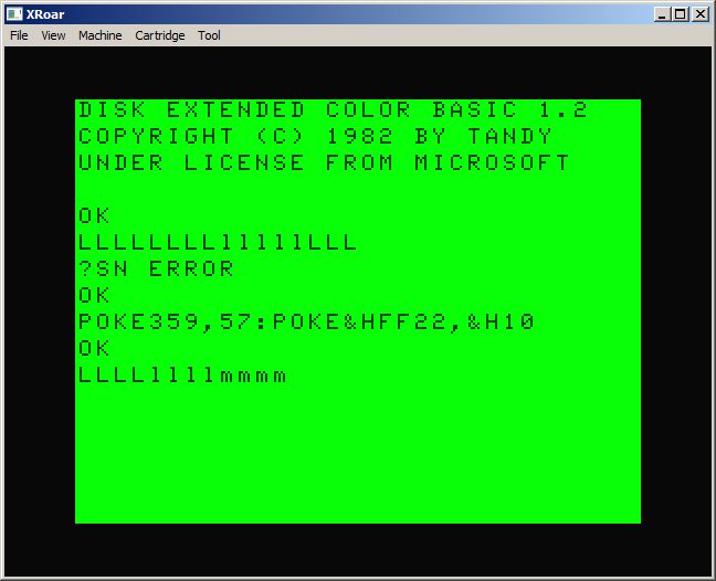

once tested all the Dragon simulations (except Alpha and Beta for wich I assume there is no chance to be simulated), I have begun with the CoCo's.
The main difference between the CoCo2 an dthe CoCo2B should be the fact that the latter has a 6847t1 inside wich should admit lower case letters ...
The only difference I have seen is that the lower case in a standard CoCo have been designed to use the lower rows of the char, but the CoCo2B uses the upper rows instead.
I have been trying to change to lower case in the CoCo2B with sentences like:
POKE&HFF22,PEEK(&HFF22)or16
Have tryed ORing values like 32, 48, 64, 80 as explained in Tandy's Little Wonder, but none of them made any change.
I have not found any hint inside the XRoar manual, despite it indicates that the chip is emulated for these CoCo2B's.
Does anybody know what should be done to switch to lowercase emulation?
thanks beforehand
Posts: 1809
Re: XRoar 0.32 released
this is the right way to get the lowercas letters:
POKE359,57:POKE&HFF22,&H10
Once done, yo press Ctrl+Z to get the native CoCo Keyboard and then pressing Shift+0 gives you the true lowercase letters
screenshot
screenshot
Xroar Emulating CoCo2B Lowercase letters.jpg (36.38 KiB) Viewed 6432 times
