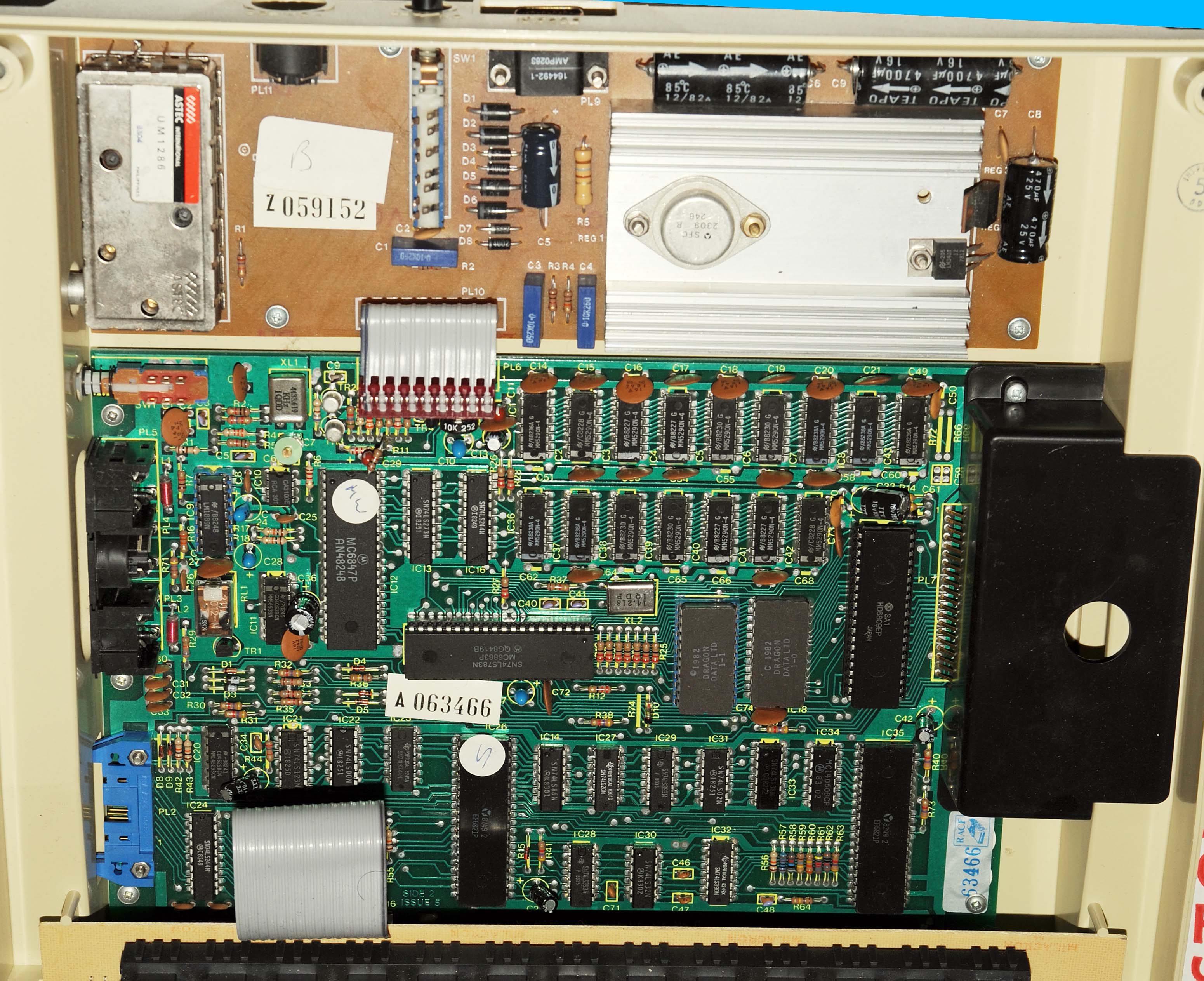

Vato wrote:I just opened my old 32 for the first time today, and saw that there is a power and video board separate from the main board.
Which of the following is your mainboard?
(1) 16x16 - Two rows of RAM chips, 1x9 and 1x7
(2) Piggy Back - 6 chips on main board, piggy back board in sockets 1 and 8, 11 chips on piggy back board
(3) Siemens - 1 row of 16 RAM chips, 2 chips per socket (one chip on top of another)
(4) OKI - 8 RAM chips (usually labelled OKI)
Vato
I'll snap a photo of it ;-)

here's a shot of the inside of my D32. If you view it full size, you should be able to read the text on the chips.
Please tell me what you find.... what version etc.
Thanks
V

Wow... that came up big.... is it possible to show the attachment as a thumbnail?
D32 bowels
D32 bowels

That's an issue 5 board with 16x16 - two rows of RAM chips, 1x9 and 1x7, and 14.218 MHz crystal rather than the 14.21818 MHz crystal fitted to early models. That's quite a late issue board.
You can read about the 14.218 MHz crystals here.
http://www.grempc.demon.co.uk/dragon/info/d64difs.html

I find it rather strange that it's a late board, as the D32 was given to me on May 8th 1983, under a year after it was released. I remember the exact date for various reasons. But it WAS sent back for repair some time during 1984 (I believe). Maybe they changed the whole board?
The SN under the case is 094220, and I have seen substantially higher SN's than that.
