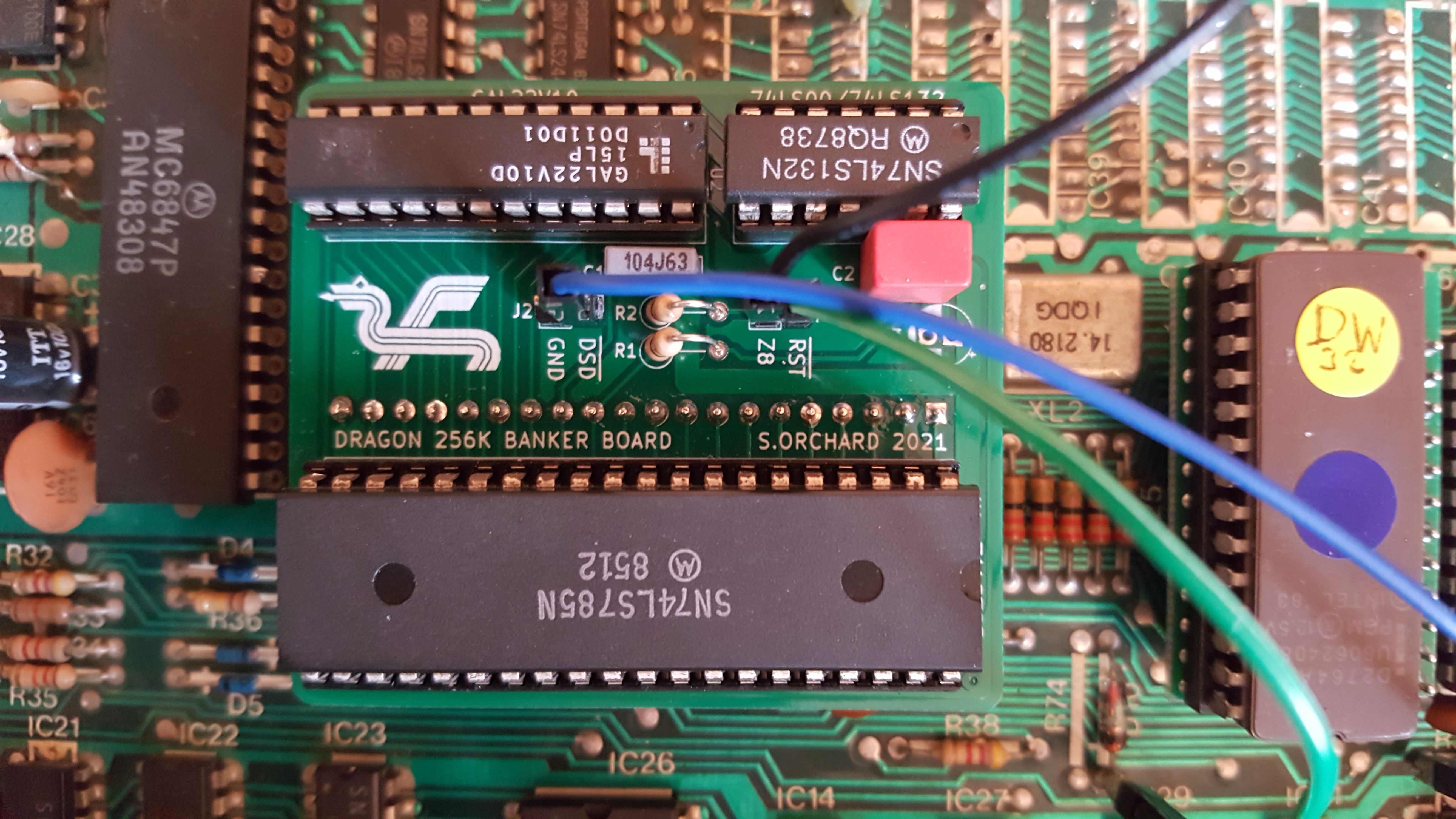

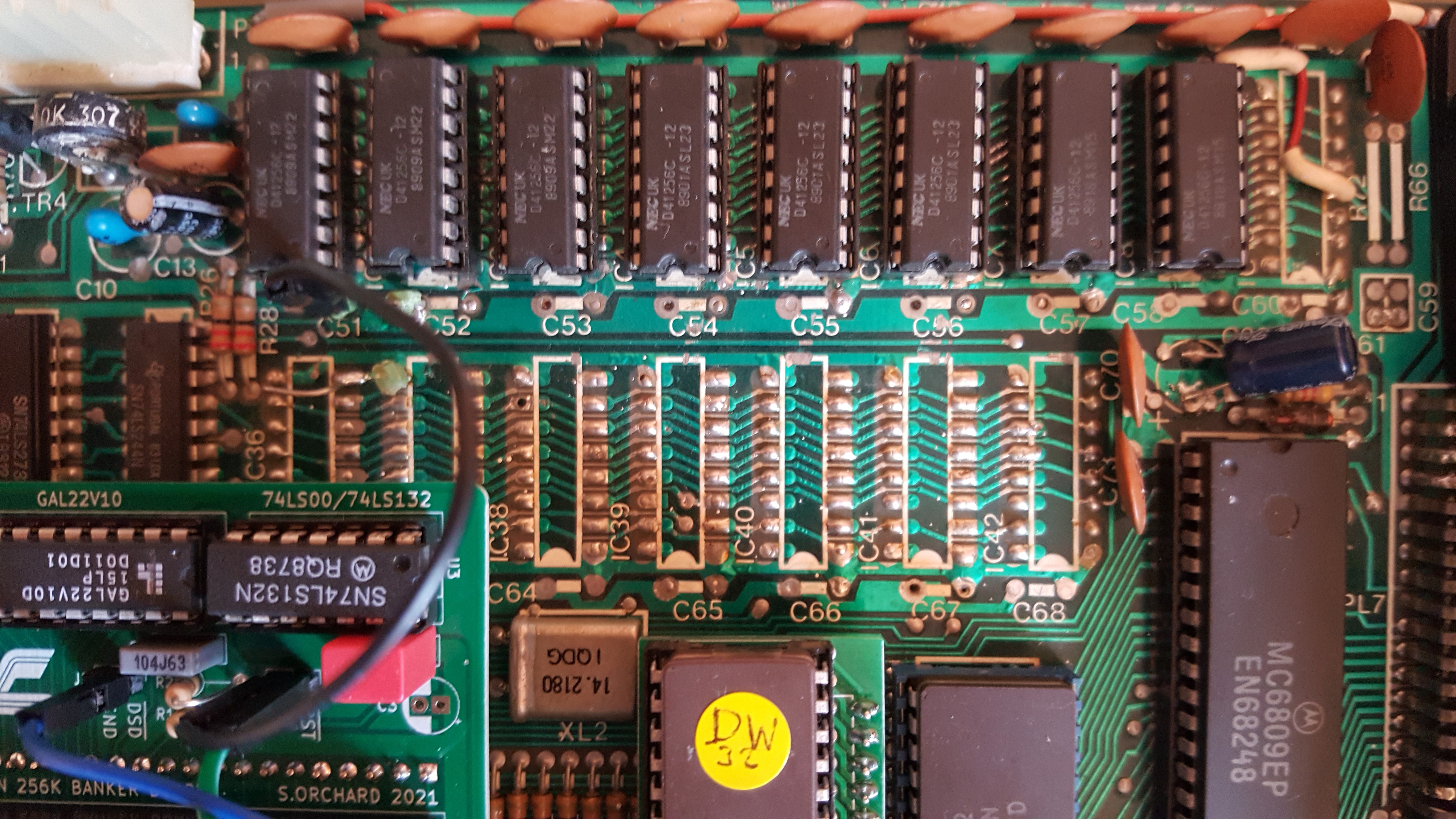

I've gone old school with my upgrade: It's based on a design for the CoCo from the 80's that provides the extra address line required to drive 256K DRAMs fitted to the Dragon main board. The memory is banked in 32K pages, limiting your options as far as operating systems go, but still useful e.g. RAM disk, sideways software, banked rom emulation, high-res text display in shadow ram etc.
The main prerequisite is you need your 64K memory socketed, so that it can be replaced with 256K. More details here
The pcb design has been successfully tested in a (formerly) 64K upgraded Dragon 32.

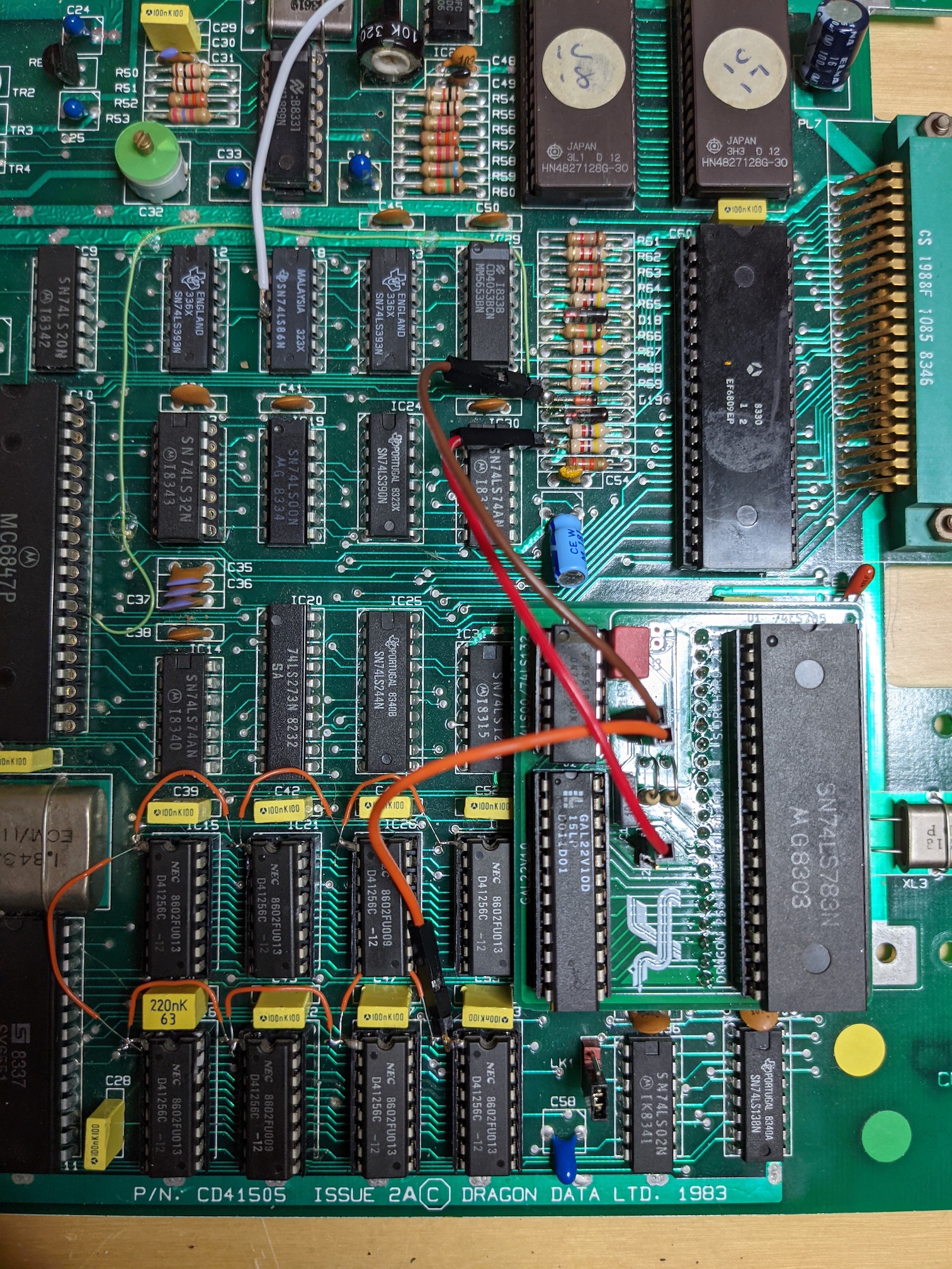

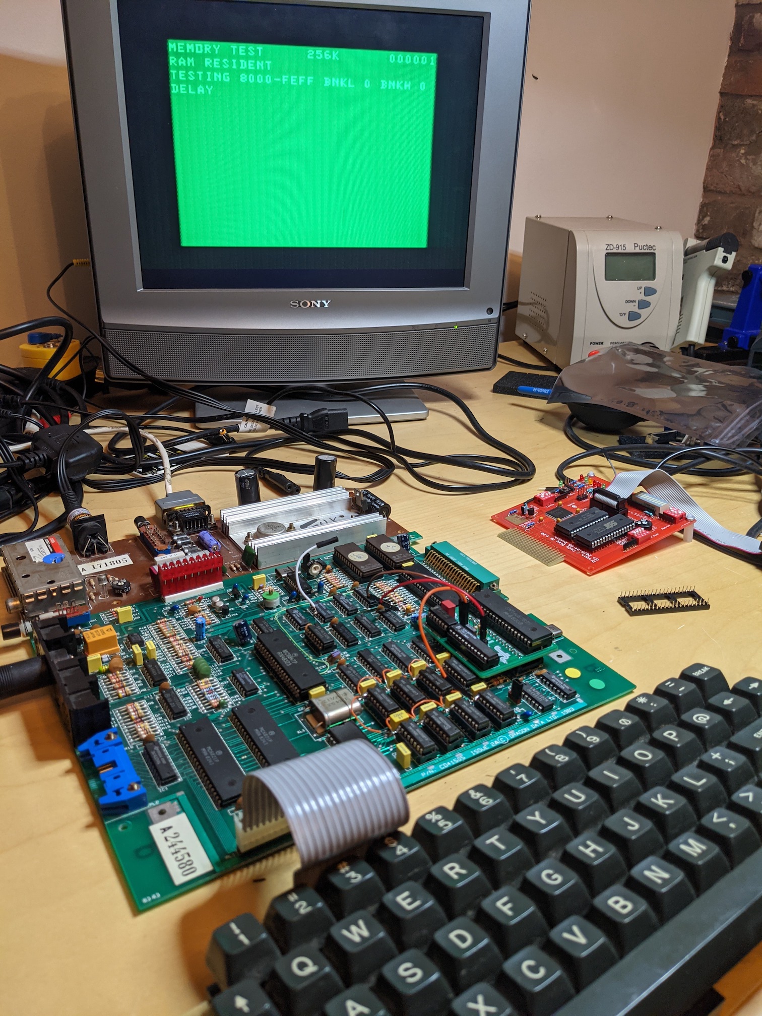

Posts: 372
Re: DRAM data retention time
And here it is working happily on a D64. A little fiddlier - socketing the RAM was a bit of a nightmare, as the tiniest bit of solder left on the component side would mean torn pads and traces when I tried to the remove the chip (so there's a few bodge wires on the underside!). But it's sitting there running its tests, and working fine! Cheers Stew!
