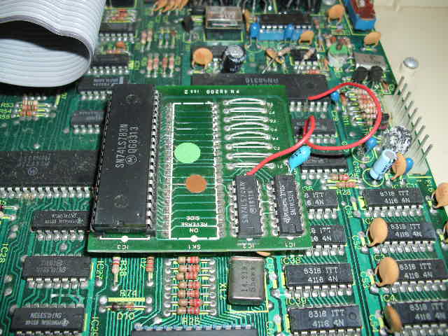

I have a Dragon 32 with an Issue 5A mainboard (16x16) and a MK3, Issue 4 power board. The mainboard has an extra little PCB which is plugged directly into the socked where the SAM chip usually sits. The top of the PCB is comprised of a socketed SAM chip (SN74LS783N), two smaller chips (SN74LS74AN, SN74LS32N), and a tiny blue 16v capacitor. There is a long thin red wire which goes from the middle of the PCB to pin 37 of the MC6847 VDG chip. As the seals were all intact, this extra PCB must have been fitted at the factory.
Does anyone know what this board is for?
Extra PCB fitted to Dragon 32

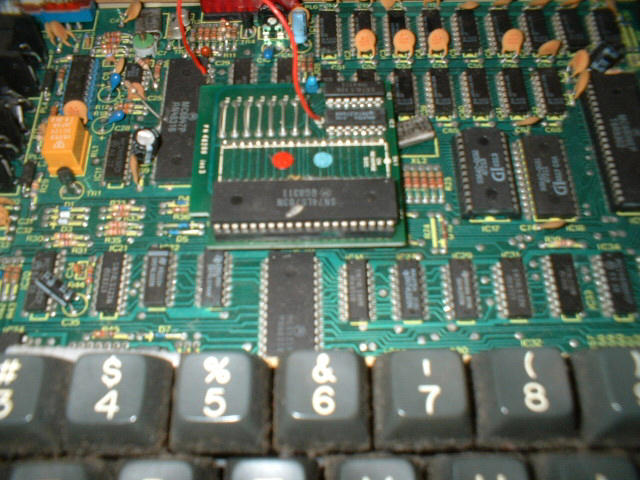

I found this poor quality picture of a Dragon 32 with the very same board fitted on eBay today. It may not be very helpful but at least you now have a visual reference.
- Dragon32_extra_board.jpg (87.25 KiB) Viewed 15041 times

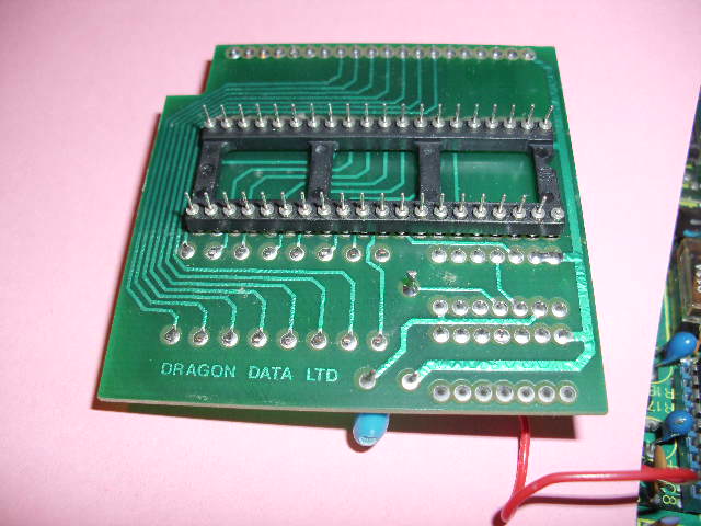

I also have a non-working Dragon 32, listed on ebay with this board - photos are attached (of top and bottom)....
The board is marked Dargon Data Limited, so must have been a standard fit for something!!
- DSCI0003 (3).JPG (116.09 KiB) Viewed 14997 times
- DSCI0001 (2).JPG (116.6 KiB) Viewed 14997 times

Whilst I was repairing the add-on board I desoldered the 2 LS chips and traced the board, what it seems to do is two things :
1) Makes sure that DA0 on the SAM is forced high whilst frame sync is low (i.e. in between frames).
2) Makes sure that transitions of horizontal sync only happen on the falling edge of the E clock.
The net effect of these two seems to be to clean up the video signal, on my LCD TV, fed from the monitor socket on the Dragon the picture is much shaper, especially in text mode and pmode 4.
I may try replicating the board and fitting to some of my other Dragons.
Anyway I'll attach the circuit diagram, and incase anyone is interested I have re-produced that board as an Eagle 5.x project complete with board layout if anyone wants it, just ask, or I can post here
if there is any interest.
