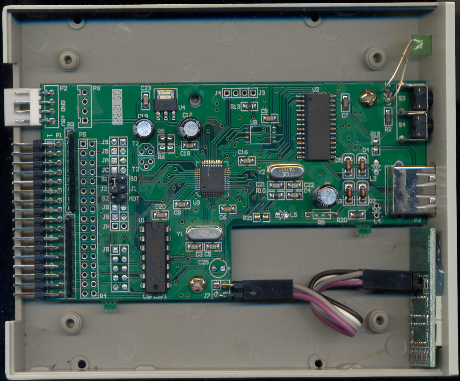

Hi Juan Carlos!
I think I have a 1.44Mb emulator I bought some years ago somewhere in my room. How can I help you? Is there anything I can test for you?
I've attached a picture of the PCB of my emulator, in case it's helpful.

- Chinese 1.44Mb Floppy Emulator PCB
- USB_FloppyEmul_Top.jpg (254.72 KiB) Viewed 9700 times

Aha. Yes, that can be useful. I'm going to abuse your goodwill now.
First of all, the emulator has to be set as Drive 0. From the looks of it (my emulator's PCB is very different), I strongly suspect you only need to move that jumper from J2-S1 to J1-S0. Then connect it to the Lafumat board with a non-twisted flat, feed 5V to the emulator, put a thumb drive in, and turn the Dragon on.
