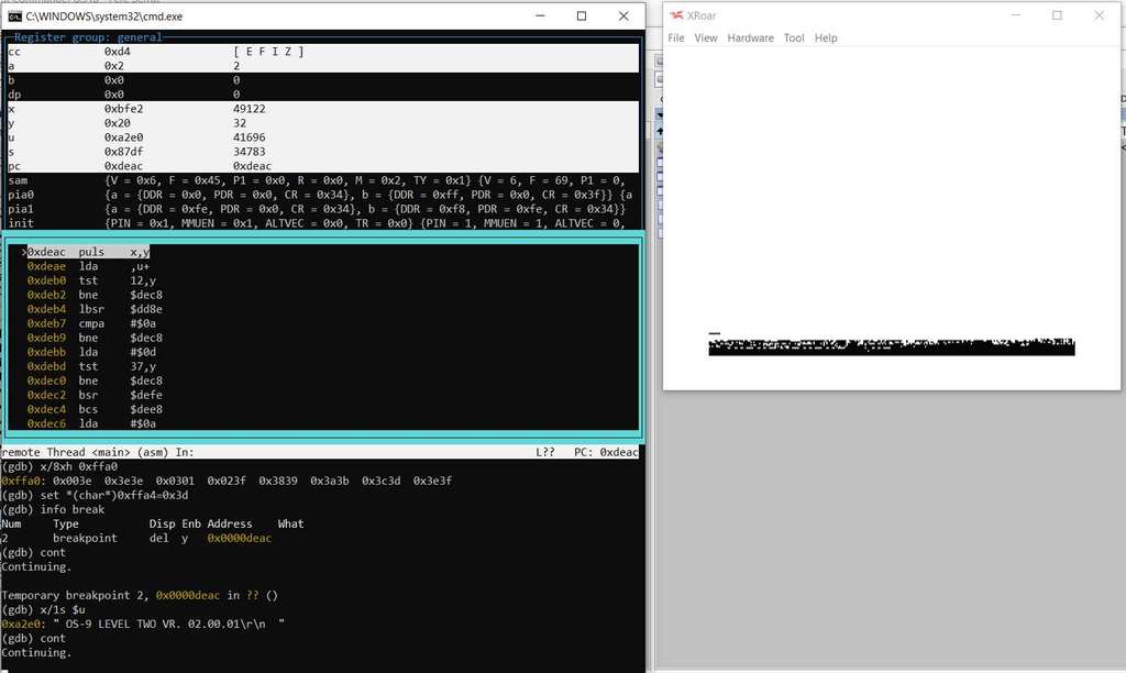

After some days trying different ideas in order to force the system to use page $3d (mandatory being $3x) for iMMUnity module, I have not
succeeded to show correctly the text on screen.
Tracing the code manually and correcting on the fly the values to force page $3d being used has been the way I have tried most of the time, but always have ended with system hanging as soon as I have set a breakpoint before printing code ...
Finally have tried the most 'hard way' I have imagined, letting the system reserve the video memory and then modifying manually all of the associated tables so that they correspond to using page $3d. I have changed tables $200,$900,$640 and $ffa4 besides byte at $a31d that contains starting address
In this last case, as soon as the system has to print a string, it creates garbage at the very last line of the screen and immediately hangs
So it is not using the table of compressed chars that has been using when no mods where applied to the std code ...
This seems to point to one or more variables (system or not) that I have not updated and so they could be the reason for the crash ...
See image of the crash
Any idea would be very appreciated!
PS. I don't think this will cure the problem, but I see that I forgot to update the video offset on the SAM registers. Will do another run!
