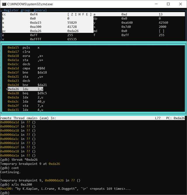

By the way, while tracing till this point, I found an apparently Easter egg. It is an encoded string just using the eor function.
The text that appears seem to be the name of three important people inside Microware:
- The president and the OS9 programmers (one for sure ...) See image

Yes, this is the default keyboard buffer string in SCF (we changed it in NitrOS9, naturally!). If you hit CTRL-A (or SHIFT-RIGHT ARROW in NitrOS9 Level 2) before you type anything else in any SCF device (screen, window, terminal, etc.), that hidden credits message will show up.pser1 wrote: ↑Fri Jul 24, 2026 2:12 pm By the way, while tracing till this point, I found an apparently Easter egg. It is an encoded string just using the eor function.

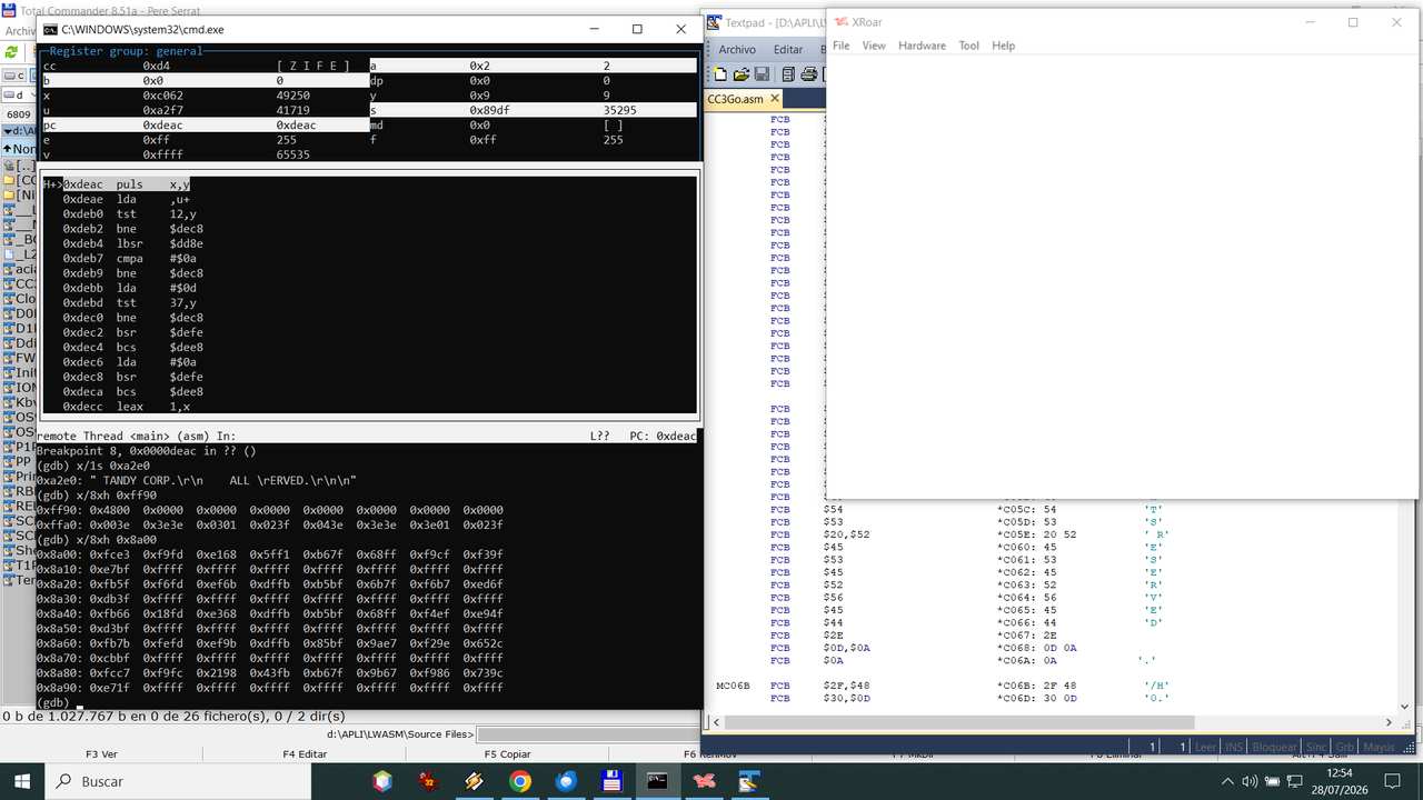

I have debugged/traced that code three more times to be sure that the welcome message is correctly processed.
OS9 returned address $8a00 as the beginning of the $1800 area we need for PMode4
The module CC3Go prepares chunks of 32 chars (copied to $a2e0) and then calls the function F$Write that reads
every char and then processes it applying 4 masks and the result is put into RAM in the reserved range ($8a00 ...)
The message is processed in five parts because it has length $89 = 137 (4x32+9)
Despite I can see the values POKEd in the RAM area, nothing is shown on screen
I cannot understand that behaviour. I don't know if this could be the result of one or more wrong parameters in
modules like SCF, Kbvdio, Term ...
Looking at the MMU pages, I can see slot 4 for task #0 associated to physical page #03
But for task #1 in that same slot there is value '3e' that seems to denote slot not in use
OS9 writes from task #0 and when finished returns control to CC3Go so I imagine that this is the point where it
changes back to task #1.
Could anyone shine a bit of light to solve this 'white screen' problem?
Thanks beforehand

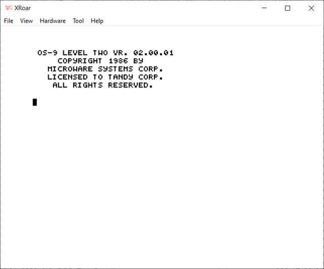

Just to prove that the intro message is well depicted on screen despite being not visible ...
I have saved a Snapshot from XRoar and then have found the beginning of the data at $86C70
I have used an hexadecimal editor to cut out just some $1600 bytes into a Dragon binary file
Then I have started a Dragon emulation, set PMode4, PCLS1, SCREEN1,1 and set an infinite loop
While looping I can load from disk the file into memory ($C00 on)
The result is in the image below. So the masking system works flawlessly.
Now we need to find a way to make it appear on screen.
Seems easy, doesn't it?
But I cannot see what's preventing it to be shown
