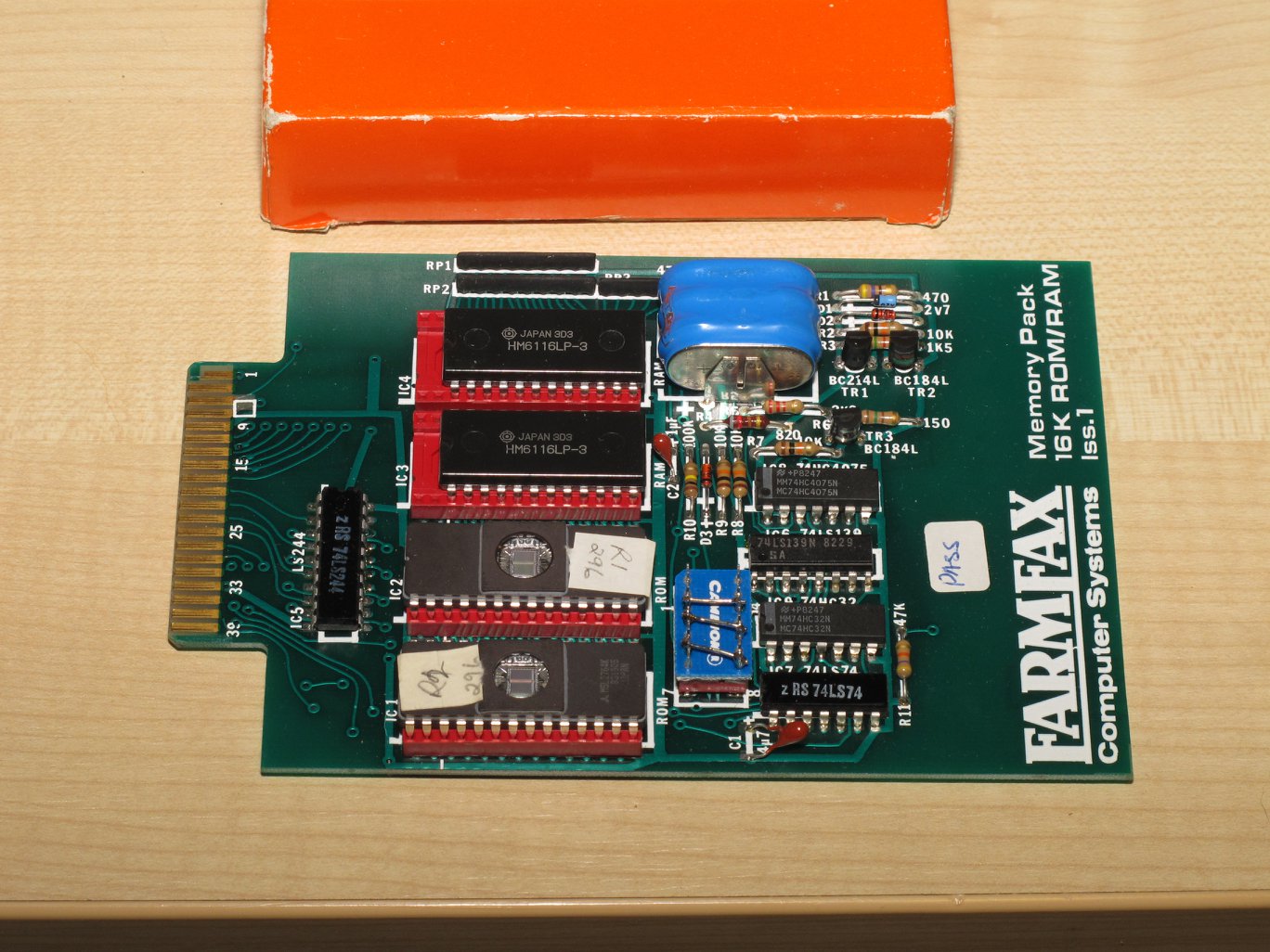

Does anybody remember what kind of battery should be soldered on the FARMFAX module 16K RAM-ROM?
I remember it was something like 4,8V but I am not sure about that ...
Thanks beforehand!

Fortunately, we have scanned the Agro Systemes cartridge which is the same as the FarmFax one (it even says FarmFax on the PCB... :lol: ).
So, it should be a 3.6v 110mAh battery. Or two, as it seems that there's room for a second battery that would keep power to the second memory bank.

But I am afraid that the FarmFax board (not the french one) was not exactly the same.
I attach here an image showing the battery that is not round as the one shown in your image.
Keeping into account that the SRAM and ROM in that module work at +5V I was hoping that
the battery should be +4,8V but, of course, I may be completely wrong. I am not sure if using just 3V3
would be enough to avoid the SRAM to lose its info.
FarmFax - ROM-RAM expansion cartridge.jpg (252.59 KiB) Viewed 635 times

well, after looking at the datasheet for the SRAM chips it seems that any value over 2V would be enough for data retention
So the value 3,6V must be the correct one.
Thanks one more time!

My board is an Issue 2 board while yours is an Issue 1. I see a lot of common elements but didn't expect them to be also that different.
Could you please take some nice pictures of both sides of your board? I'll take care of adjusting them, correct the perspective and clean them up for the wiki.

I attach here some images related to the FarmFax memory module I have
The zip contains the big files downloaded from my phone.
I hope that is better than reducing them to be shown on screen here
