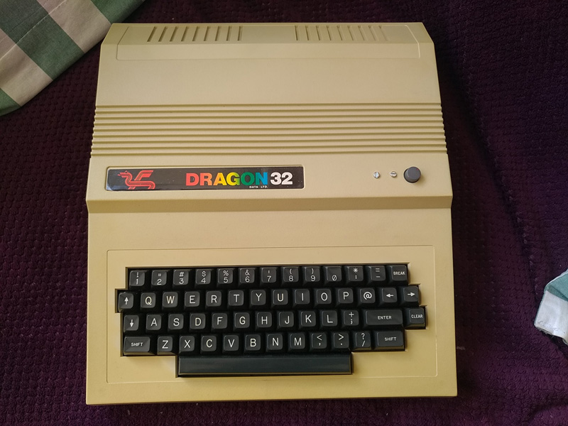

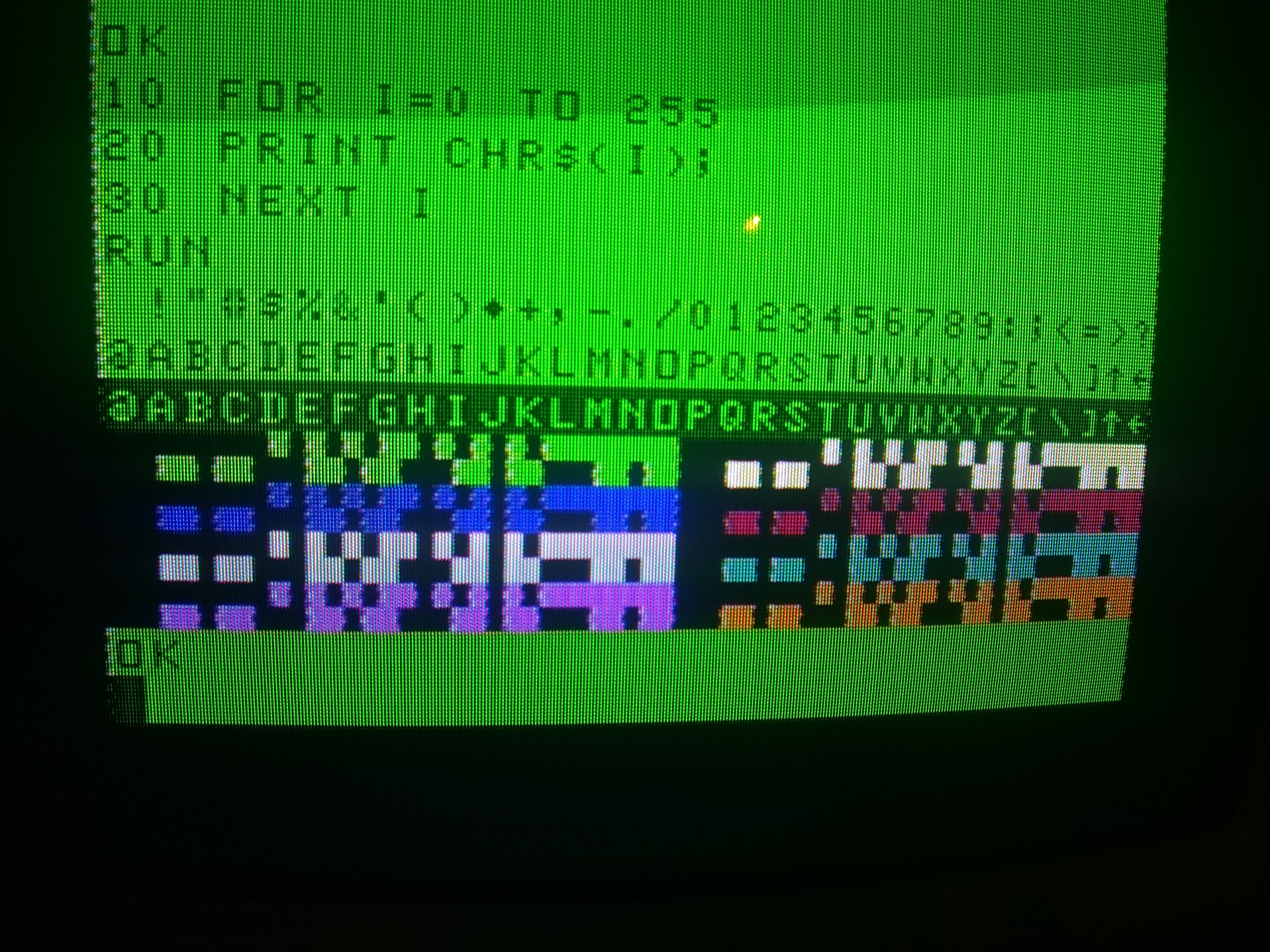

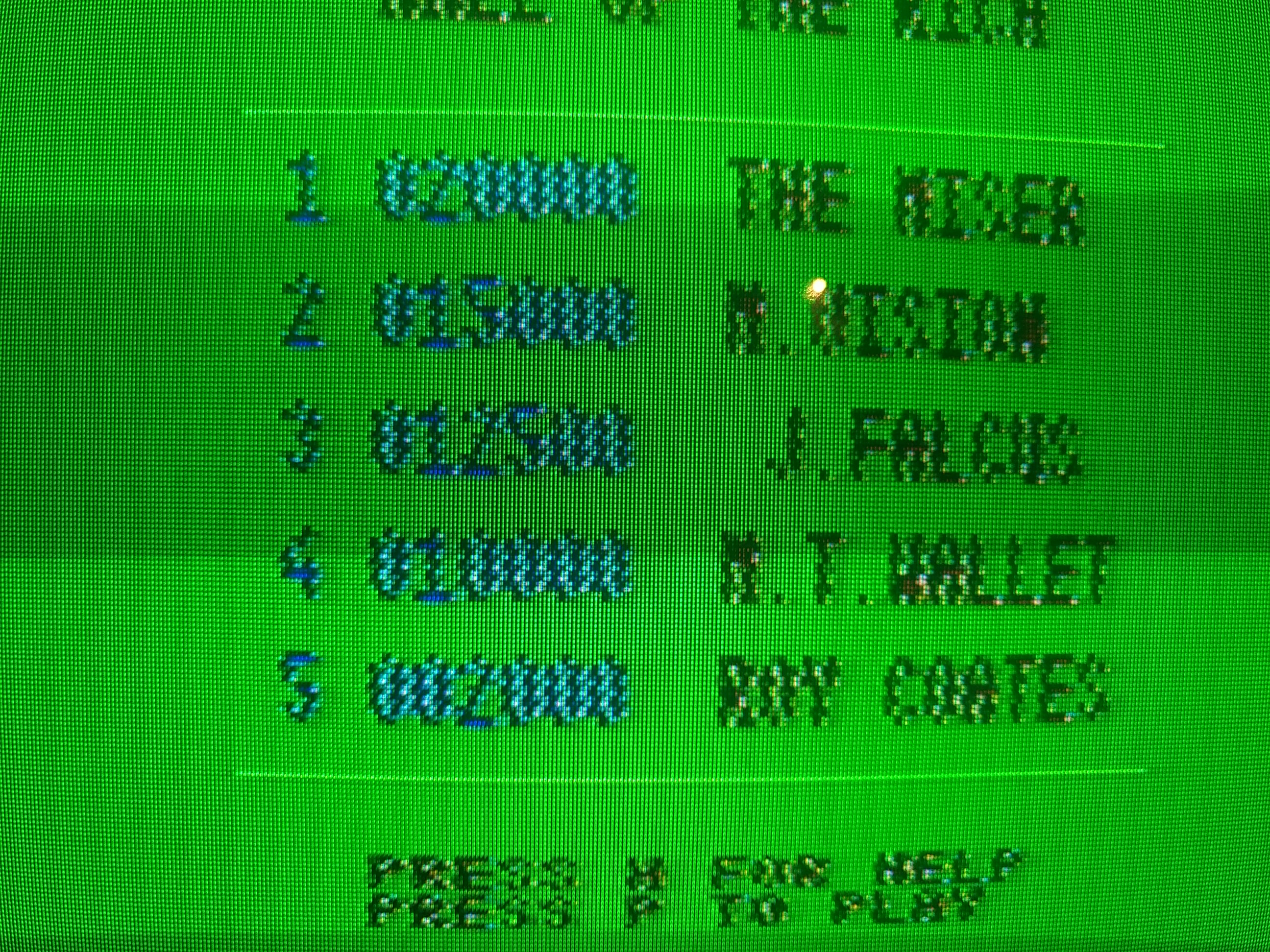

I have a PAL dragon made in Swansea, I like it very much and everything works except that it has a display problem: as soon as there is color, characters or graphics oscillate quickly from bottom to top, vertically and are not sometimes filled, so they are difficult to understand and painful to look at

Unfortunately this is a normal 'feature' of a Dragon. It's just dot crawl resulting from a lack of fixed relationship between the pixel and chroma clocks.
Later versions have a 2-22pF trimmer cap in the position of C7. This can be adjusted for best appearance but it will drift due to temperature.
Older machines have a fixed capacitor in this position. I've replaced this with a trimmer cap in a couple of my machines.
Hope this helps!

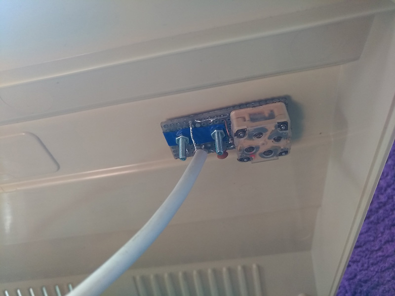

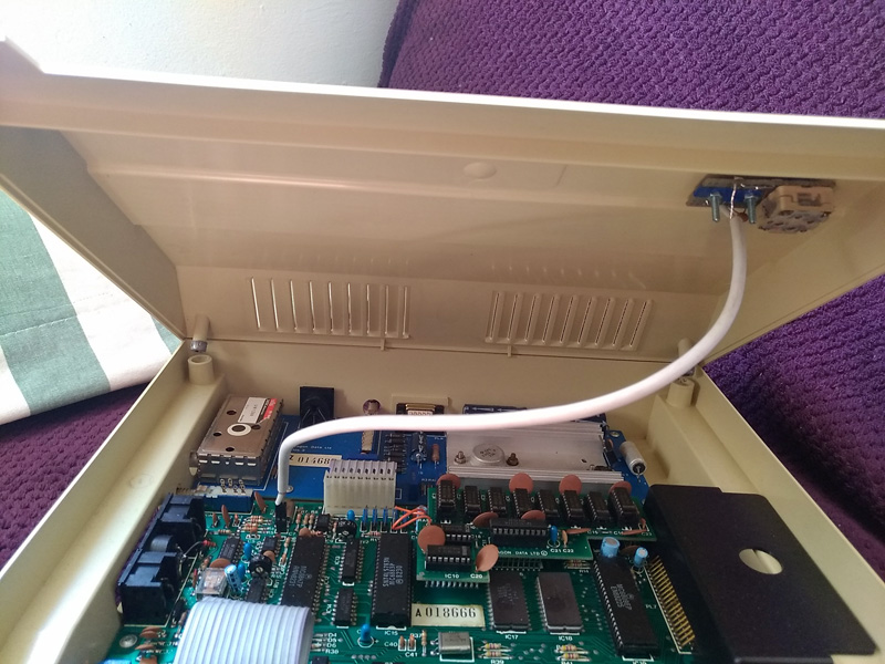

However I made a video mod for my dragon which is completely acceptable:
This mod consists in recovering a variable capacitor from a small FM radio, manage to sold it to a support and build an axis in order to add a rotary button. Put in serie a 22PF capacitor with the variable capacitor and it is very important to connect the module to the motherboard with coaxial cable before installing the module on the dragon enclosure. It works very well.

Just popped in to say I love this fix! In my time as a collector of Dragons I have seen so many hacks to try and improve the video quality, but this is a new one on me
