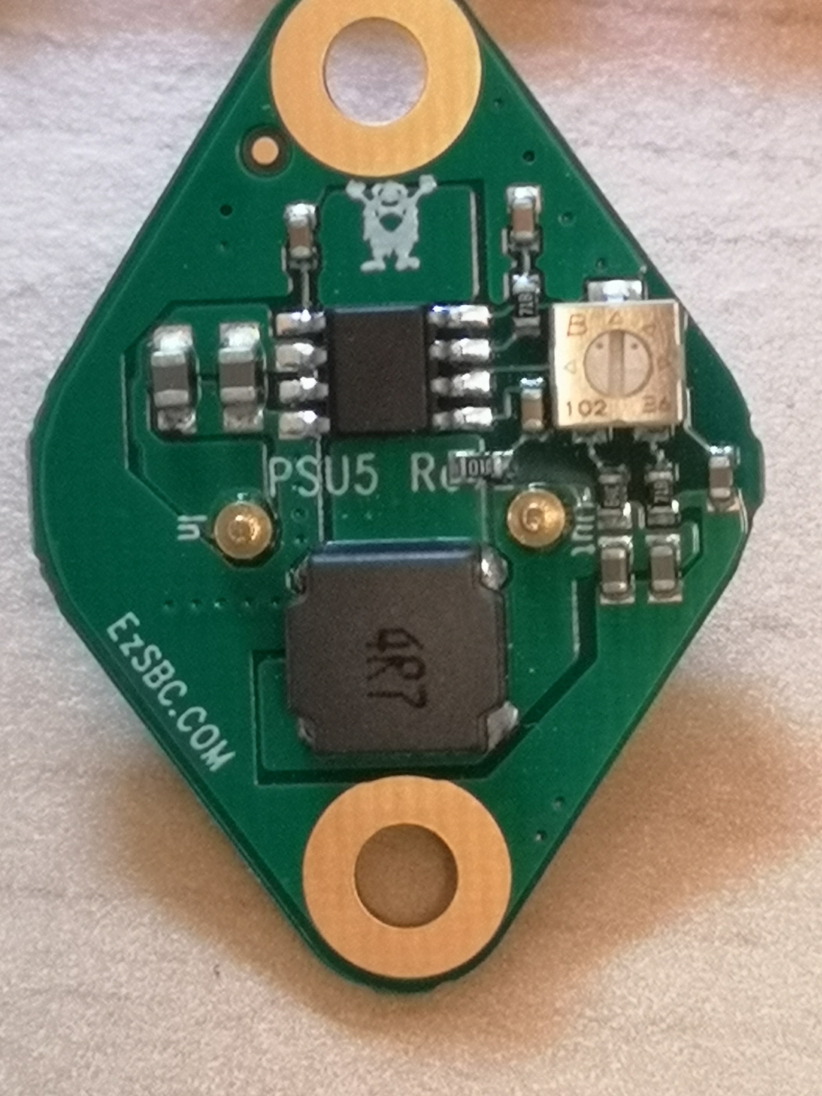

The TO-3 packaged switch mode converters ... this looks like them...
https://www.ezsbc.com/index.php/psu5.html
Too tempting not to try, have ordered a couple.

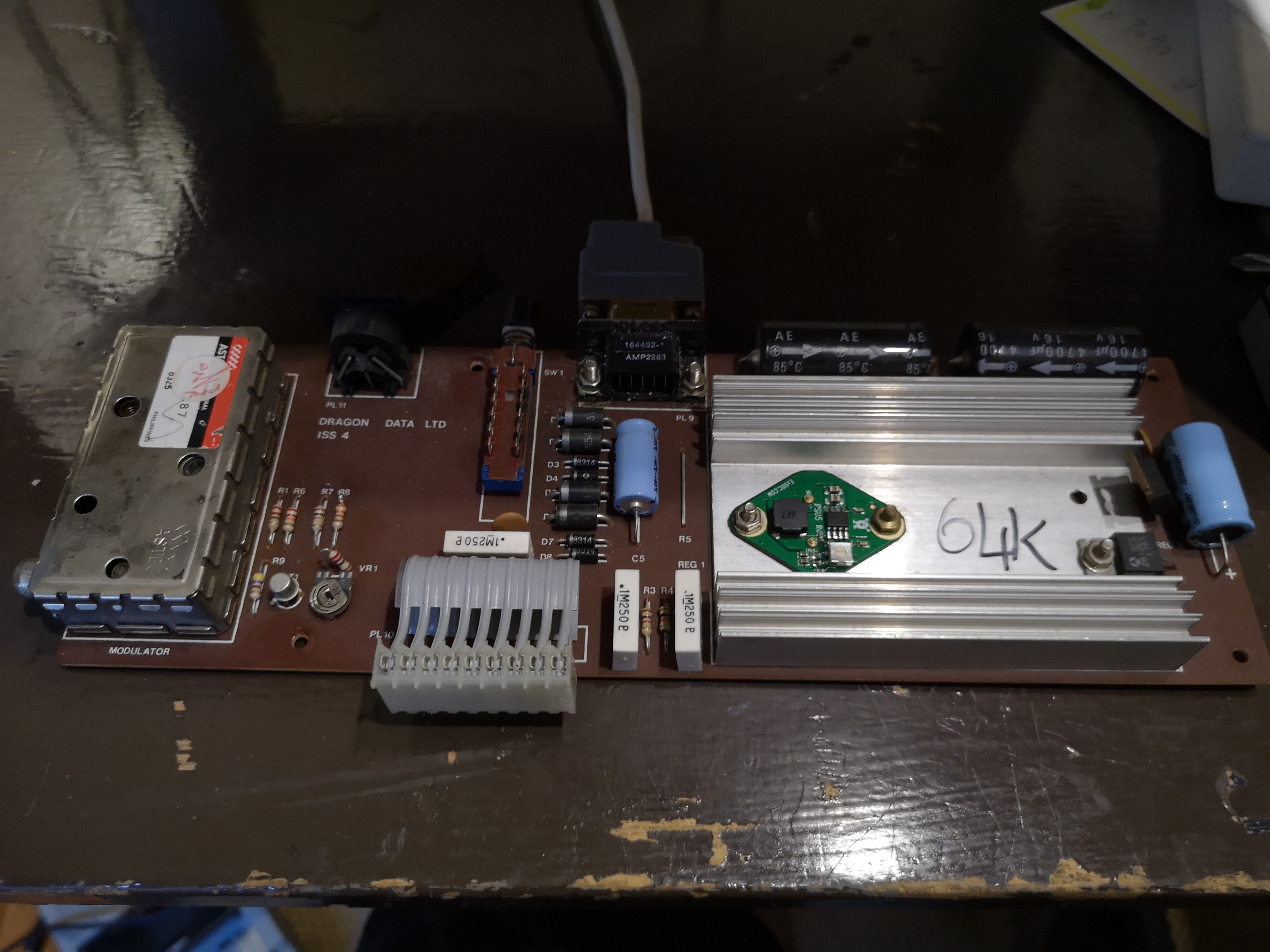

Well, the TO-3 LM309 replacements arrived.

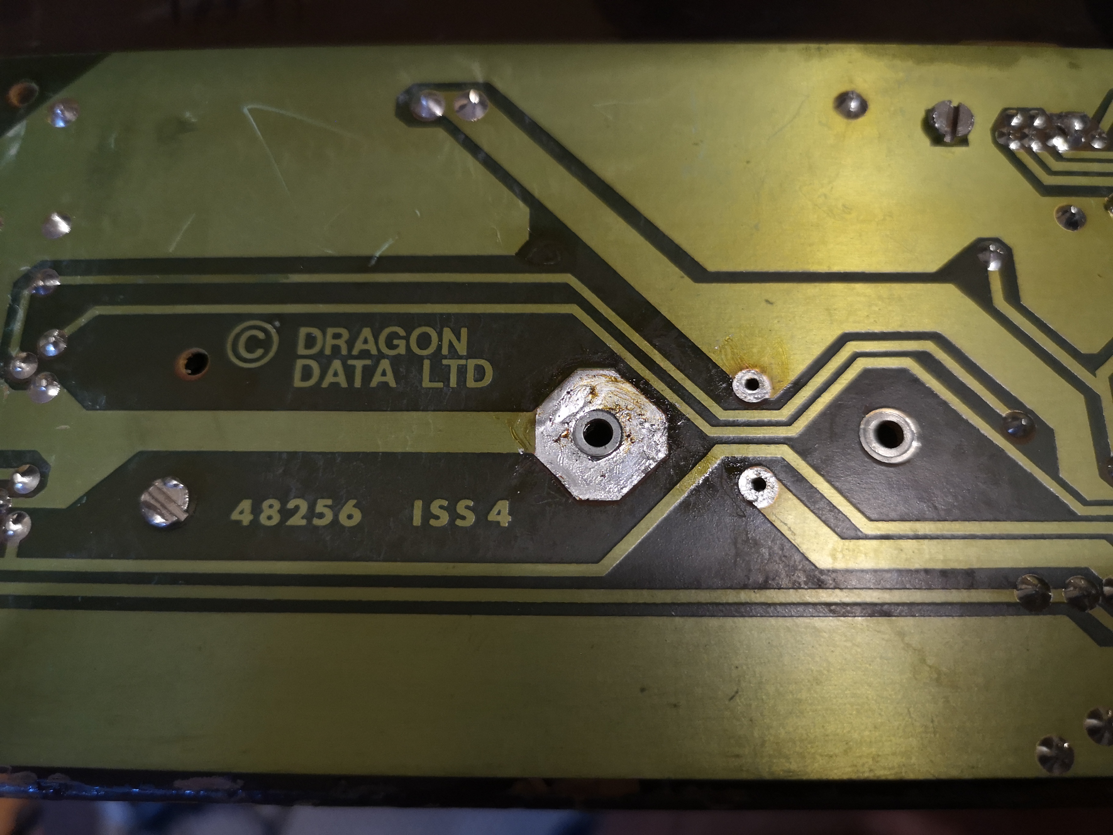

and I (with some trepidation) took the de-soldering iron and braid to the power board on my workhorse D64.
Actually, I probably didn't need to desolder the main through heatsink GND bolts, they could simply have been left in place and the top side nuts and washers removed, but anyway.

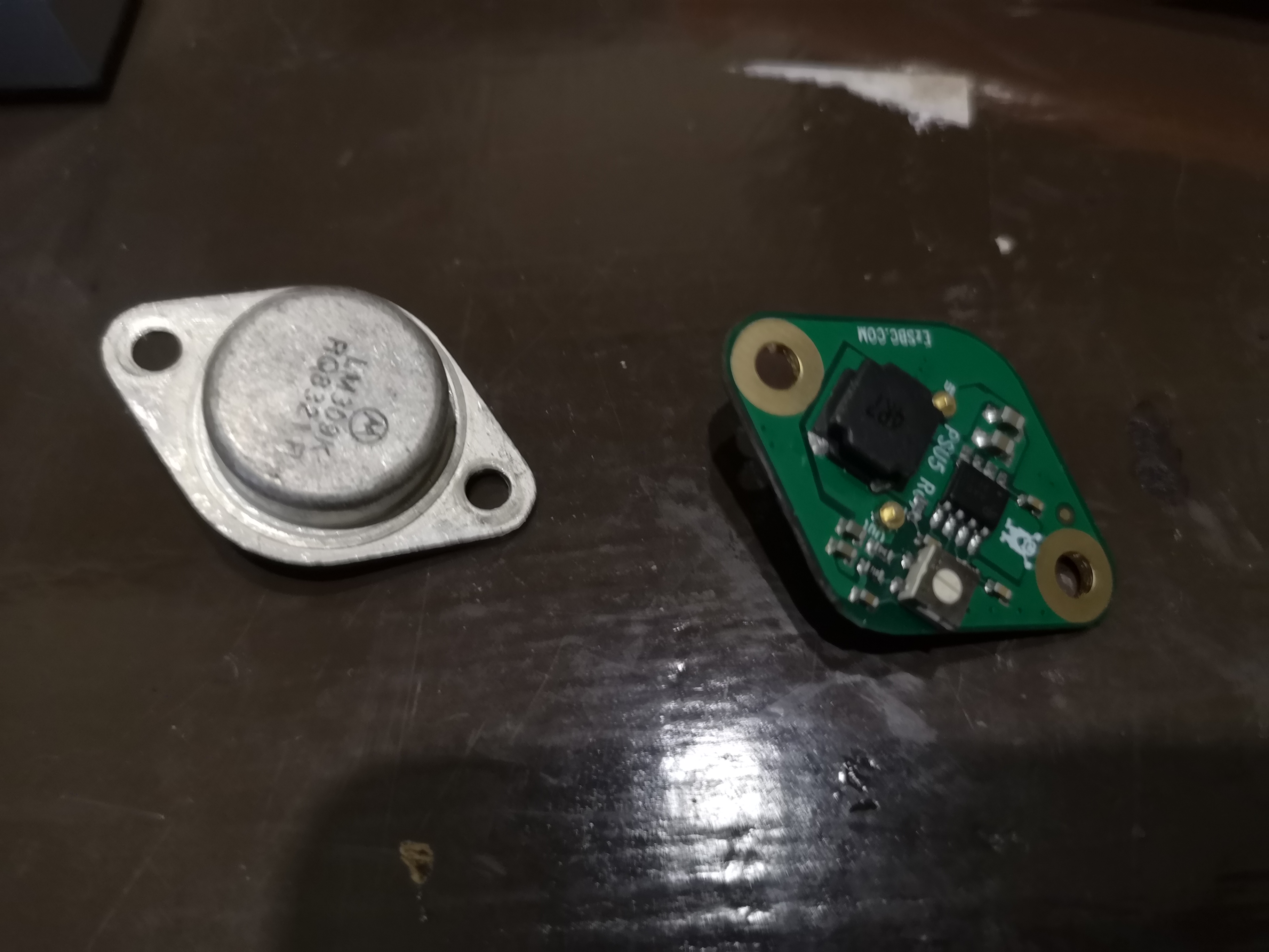

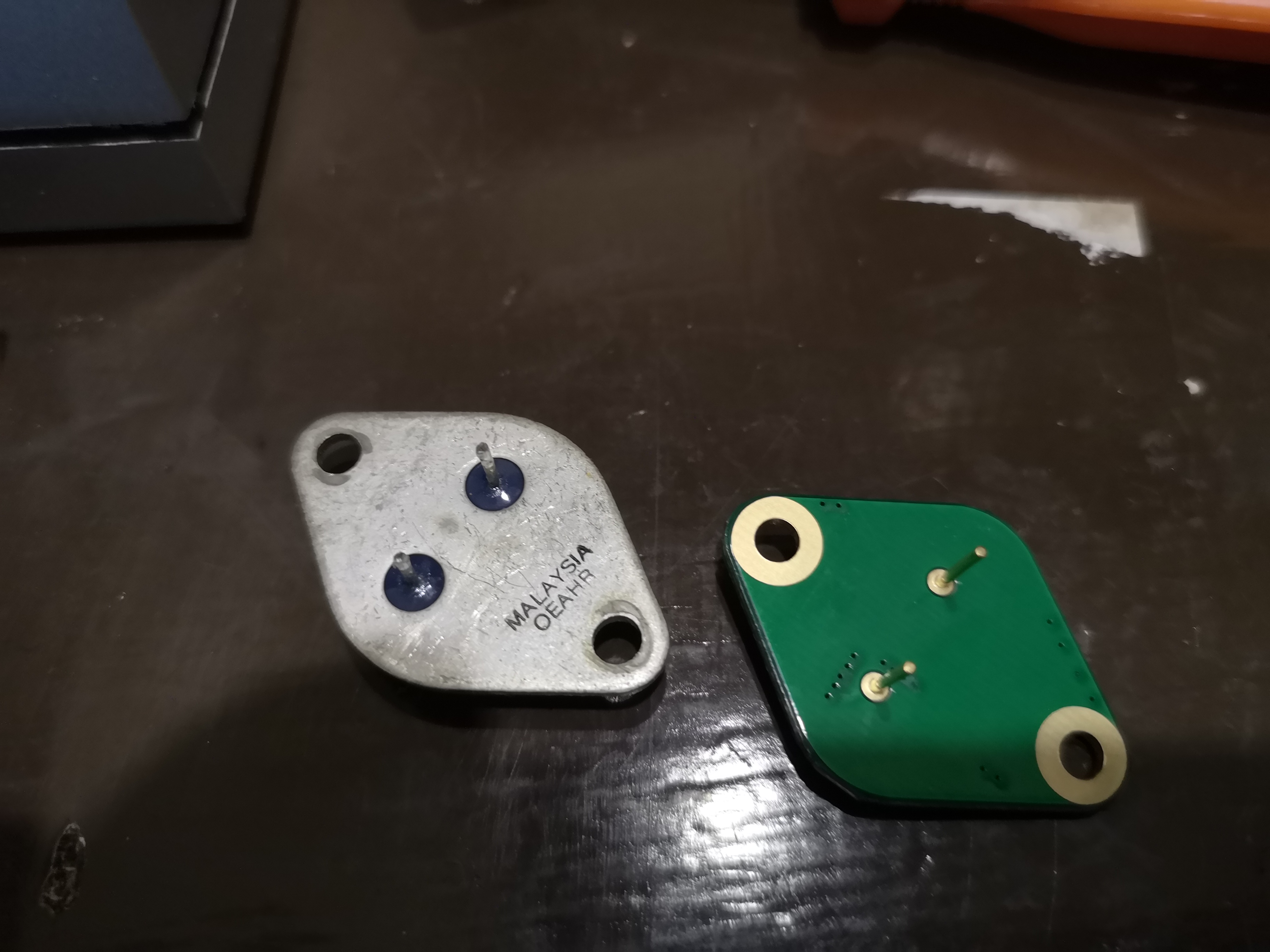

Old school linear and new switched mode:
And new switch mode installed in the power board. There's a trim pot to set the voltage accurately.
Picture is good, possibly picture quality is a little improved overall, and stability with time / temperature seems better.
Booting Os9 from SDC seems more reliable (even with my new WifiSD card, which was really problemmatic).
Heatsink is now never more than warm.
