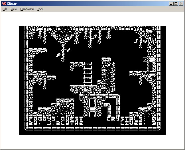

This is a screenshot of the first location of the game.
By now only the blocks are depicted, next steps will be objects and sprites ... still a long way to go!
Image in PMODE4
Image in PMODE4

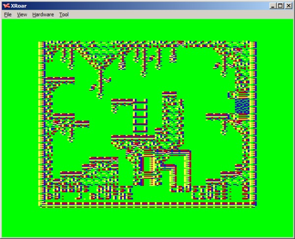

A simple change to PMODE3 with no other changes (testing)

I am waiting for a friend from Retrowiki who is converting these blocks to PMODE3
hopefully the result will be much better than the simple PMODE change!

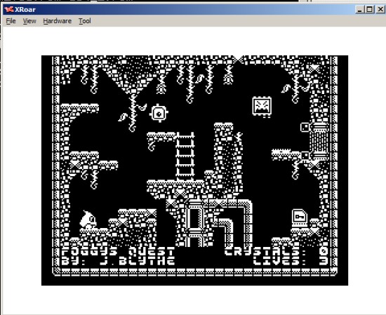

this is just a project status update. The program now draws the locations and adds the correct objects and sprites.
I have gone a bit further and have coded "evnt10" too, but this does nothing on the screen, so I will debug/trace it to verify it works fine.
Next will be the "main loop events".
Certainly I had forgotten that the 16 bit values are treated differently on the Z80 with respect to the way we they are on 6809.
As I use 16 bit registers as much as I can, I need to verify that when writting later I do that in reverse order
Blocks and Objects have been easy to port, but sprites with the (bad) trick of pointing to the ROM when out of screen, have been a nightmare.
Besides, adding the "evnt10" the global code exceeds the 32k limit on a 6809 machine. So, it was time to switch to MAP1 (all RAM),
copy there the Basic Interpreter and use the highest part of RAM for the graphics, that way some 7,197 bytes are free now and if it were the case,
I could re-use the DOS area (C000-E5FF) so 9,728 extra bytes. This has to be enough for the total port, I hope!
Right now I have all into RAM, even the ROM, so the ROM trick now overwrites the, otherwise, protected ROM contents :-(
Will add a bit of code to control that in "dline"
