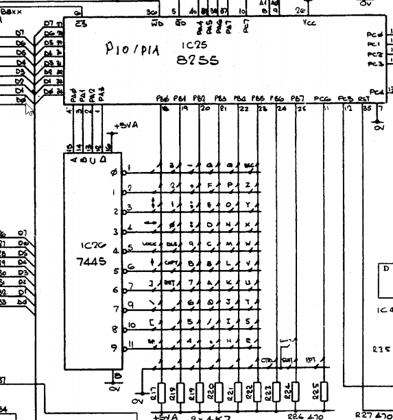

You can find a disassembly of the #Fxxx rom here: http://www.acornatom.nl/atom_handleidin ... m/f000.txt
$FE71 reads a key from the keyboard matrix from bottom left upwards and then the next column upwards, if nothing is pressed then 255 is returned.
So SPACE returns 0, RETURN returns 13, etc.
