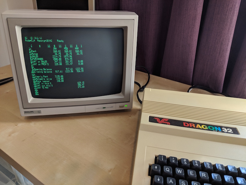

Hi all, still playing with my DragonPlus here. I'd love to see some software that takes real advantage of it. Reading this thread viewtopic.php?f=5&t=4782, there's some discussion about porting OS/9s Dynacalc and Stylograph to the Wordpak/CRT9128 80 column card. Can anyone give me pointers where to start for the DragonPlus? 80 column versions of either would be great!

I did a GO80, and it's driving my little green screen monitor just perfectly! Dynacalc and Stylograph both run, but both seem to think I have a 51 column monitor ... I'm a little out of my depth here, wondering how to tell them it's 80 columns!

What I've learned is this. First off, we have to run GO51, which loads most of the display stuff we need. Then GO80 switches over to the Compusense card. If you look at the STARTUP file on the second disk you posted ('OS-9 Level 1 V1.2 for DragonPlus (1983)(Dragon Data Ltd - Compusense)[OS-9][!].vdk') you'll see it does just that. However, if you load that VDK on Xroar, and run G051, it fails with 'error 221, module not found' - and hence that disk doesn't work.
However, that doesn't matter, because the disk you build if you follow my instructions does work. And even better news is that the copy of Stylo on your disk works at 80 columns too! So I now have a copy of DragonPlus Stylo. But Dynacalc is still only 51 columns - see the attached picture. Off to rummage through the archive, see if we might have one!

tjewell wrote: So I now have a copy of DragonPlus Stylo. But Dynacalc is still only 51 columns - see the attached picture. Off to rummage through the archive, see if we might have one!
I had not seen that Stylo had been already patched, just saw the patch to be applied reading the documents.
Now we need to know if there is a similar pacth for Dynacalc ... despite Compusense did not talk about it.
KenH
Posts: 184
Re: 80 Column OS/9 Software for the DragonPlus ...
Post by KenH »
Use Tandy Dynacalc rather than Dragon Data's.
You can use the Tandy Dynacalc version which is included in my nos9 images posted here for 80 columns:
It's based on the Tandy release of Dynacalc.
