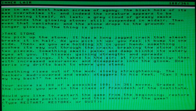

One of the advantages of having that module is that we can set it to work at 64 columns by 32 lines in mode text, enabling lowercase too!
The changes to the 'engine' I had converted have been possible thanks to Ed Snider who, very kindly, has shared with me the mods he did
on the CoCo version, thanks a lot!!
You will notice that in the extra disk "ENGINE.VDK" there are two files instead of just one.
- ENG04V32.BIN is for normal use 32 chars x 16 lines as usual
- ENG04V64.BIN is for CoCo-VGA users and will switch the module to mode 64x32 with lowercase
Keep into account that right now this works flawlessly with TANO computers (NTSC)
I know that Brendan Donahe is working hard to fine tune it for the Dragon PAL too, so it is just a question of waiting a bit to test ...
Just a proof that it works till the end, I played "The Lurking Horror" (cheating with a walkthrough) but needed to test it!
Screenshot-The Lurking Horror-END-64 columns-reduced.jpg (92.36 KiB) Viewed 4643 times

Just to let you know, this works like a dream on my CocoVGA - playing Hitchhikers Guide to the Galaxy at this very minute!
Very impressive work.
