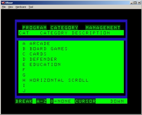

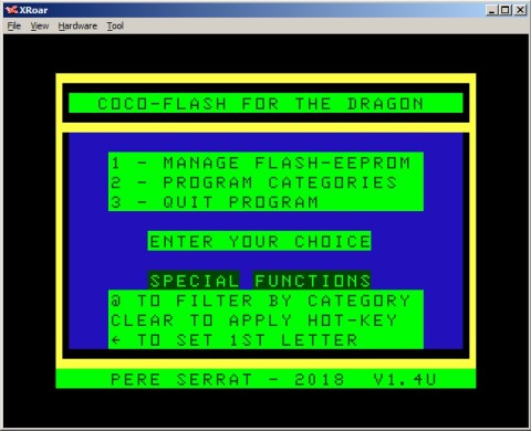

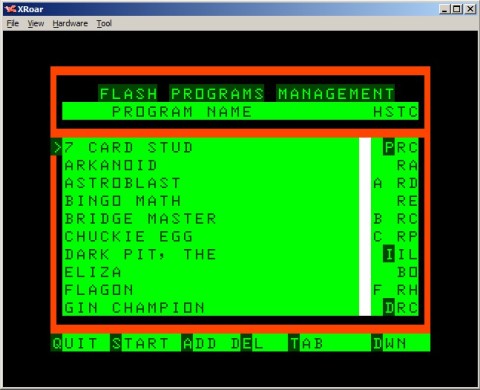

I named the program 'DFEM' that stands for "Dragon Flash Eeprom Manager"

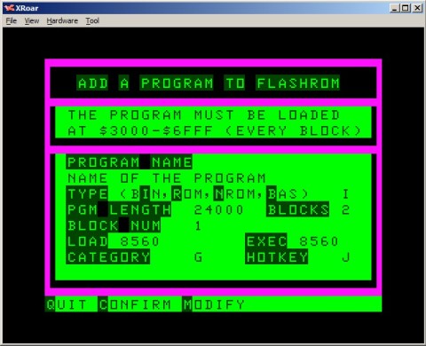

The program will 'flash' programs in chunks of 16k, from $3000-6fff and later you could start them from the program list.
I decided to allow Binary and Basic programs besides the normal ROMs, so I added some code to copy those programs to RAM
and execute/run them. These loaders are part of the Program Manager, so there is no need to add them at the beginning of
the programs we want to store in Flash.
To make it easy for the user, the module should contain a customized version of my DosPlus5.0 extended (DP50E from now on)
on bank zero. We will flash it here if it isn't yet there.
This DP50E customized version will copy some code into RAM and start it.
The copied code will switch the bank on the flash module so that it can copy the Program Manager and in turn, start it.
The only thing that the user has to do is press the button on the flash module that prevents the ROM from autostarting.
The DOS must be called by the Basic after it has initialized the Dragon. If you don't press that button, the Dragon will simply hang :-(

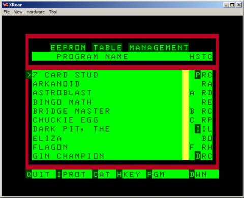

I have used the SPI EEPROM included in the module as a database where the relevant data for each program is stored.
The idea was given to me by Jim Brain.
The programs are always shown in alpha order. Basically the EEPROM contains records that point to the next one, so it is a simple linked list.
To get an idea about the capacity of that module, let's assume that all programs (Binaries/Basic/Rom) will have a mean length of 16k,
then as it has 8 Mbytes, we could add (8Mb/16k) -> 500 programs, but if they are smaller then we could add a lot more.
The limit imposed by the EEPROM database is 1600 entries, so it seems that we will not have problems for that reason.
I have created two tables into the EEPROM to help work with these program entries
- One that contains 26 Categories that can be assigned to any program
- Another for HotKeys that admits 26 entries too.
The Category can be shared by many programs, while the HotKey will point to only one program.
