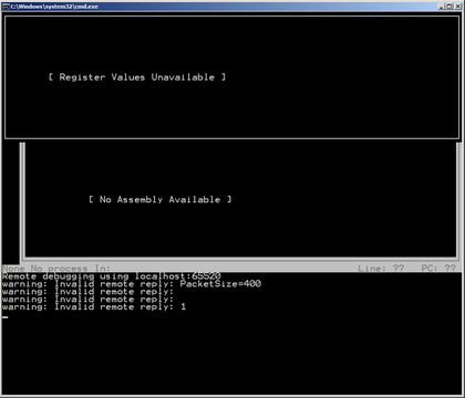

Hi Ciaran,
lately I have been forced to debug quite a lot my port of The Hobbit using
DDOS11C, DDOS13A, DDOS41 and DosPlus5.0
As my version works on MAP1, I start my program and then press a key on the GDB window
so that it intercepts XRoar, I can enter a breakpoint and so forth ...
This procedure works 100% of the times with old version 2015-33312 but fails more than
30% of the times with 2016-30041
Here is the result ...
Any idea of a way to overcome that situation?
GDB refuses to connect with XRoar small.jpg (12.85 KiB) Viewed 10426 times

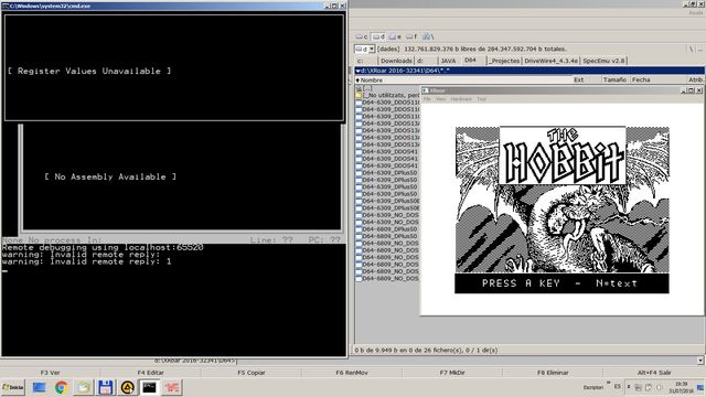

Posts: 1899
Re: XRoar, GDB
Hi Ciaran,
now that you have sorted out the error problems when there are no disks in the drives,
I am using the last snapshot 2016-32341 but this one fails to connect to GDB half the times I try.
On the other hand, the old snapshot 2015-33312 connects always at first attempt!
I include here the screenshot of both GDB and XRoar.
Could I find any 'log' file corresponding to that problem?
ScreenShot - GDB refuses to connect to XRoar-small.jpg (42.16 KiB) Viewed 10409 times
Posts: 1485
Re: XRoar, GDB
You could try running with "-debug-gdb -1" - that should emit all the gdb packets sent & received by XRoar. Of course if it doesn't connect at all, that's not going to be helpful...
Are there particular things you're doing when it fails? Quick testing under Linux shows I can connect & disconnect at will, no fails.
Posts: 1899
Re: XRoar, GDB
Hi Ciaran,
of course, when it refuses to connect, there is no log file anywhere ...
But, today it has been connecting more than 90% of the times and I have done
quite a lot of debugging!
I don't know if there is a way to tell gdb to wait a bit more time before sending the 'invalid remote reply" message
Will make more tests tomorrow in the morning
