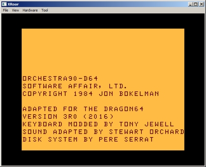

after a long time working on that project, we may finally present a working program.
We have converted the Orchestra90-CC for the Tandy CoCo to the Dragon 64.
- Tony Jewell modified the keyboard routines so that any keypress generates the CoCo code expected by the program.
- Stewart Orchard found a way and programmed the audio mods necessary to add the two channels signals (stereo) and
send the result to the internal Dragon DAC, so no need for the cartridge to be present any more!
Of course if you have it you can benefit the extra two bits definition and its stereo output.
He pushed a lot on the analysis part of the project, specially on the hardware related routines.
- I have added the code to deal with the drives natively, that means without any DOS being installed, sending commands
right to the chip inside the controller (WD2797)

Some screenshots:
Orchestra90 converted to Dragon 64

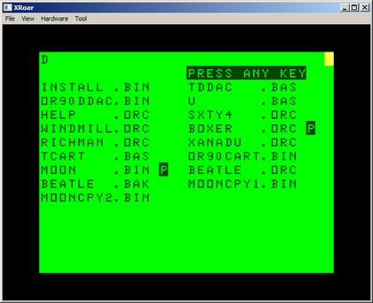

The directory has been changed to show the extension too, as you can see in the screenshots of previous message.
The program accepts * as a wild card, so you can
D 1:*.ORC will show ORC files in drive 1
D *.BAS:2 will show BAS files in drive 2
D *.* will show all files in disk 1 (default)

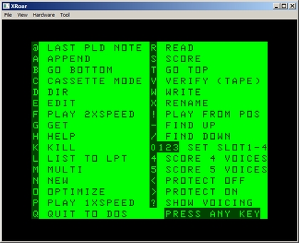

There are some changes I made to the program, specially adding commands to give more options to the user:
- F allows playing any previously scored song at double speed, at the cost of losing the screen, but it comes back when the
song ends and you gain sound quality!
- H will show a text page containing all of the accepted commands.
- K filename.ext will delete that file from the disk1
- Q allows quitting the program to the Basic interpreter to do whatever you'd need. Of course when quitting, there is NO DOS,
so dos commands will result in ?SN Error
- X allows renaming a file to another name
- < unprotects a file in the disk
- > protects a file
- > protects a file
