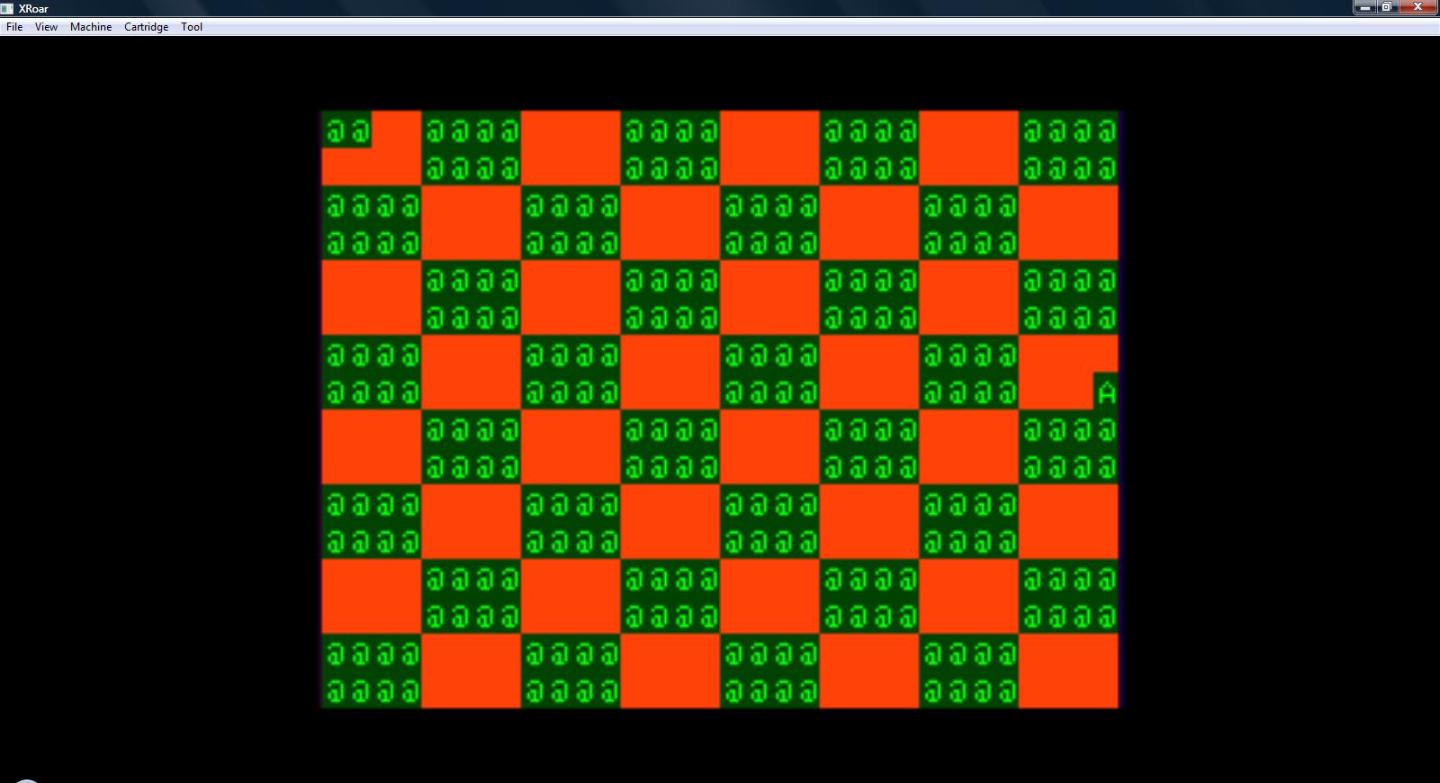

7 zip seems to be working but all I get from trying to load Xroar is this-
- Untitled.jpg (104.45 KiB) Viewed 9507 times

Looks like you don't have the BASIC ROMs around.norris wrote:7 zip seems to be working but all I get from trying to load Xroar is this-

Where do yo get those from?sixxie wrote:Looks like you don't have the BASIC ROMs around.norris wrote:7 zip seems to be working but all I get from trying to load Xroar is this-

From our Downloads section.
Download Dragon 64 IC17 and IC18 (for example), and unzip them into your XRoar folder.
Optionally, you may want to use disk software, so you'll need a disk controller rom like DragonDOS 4.0, put it on the XRoar folder, and that's it.

Thanks chuckie egg is running fine on my laptop!robcfg wrote:From our Downloads section.

Glad to know you got it working, enjoy!
