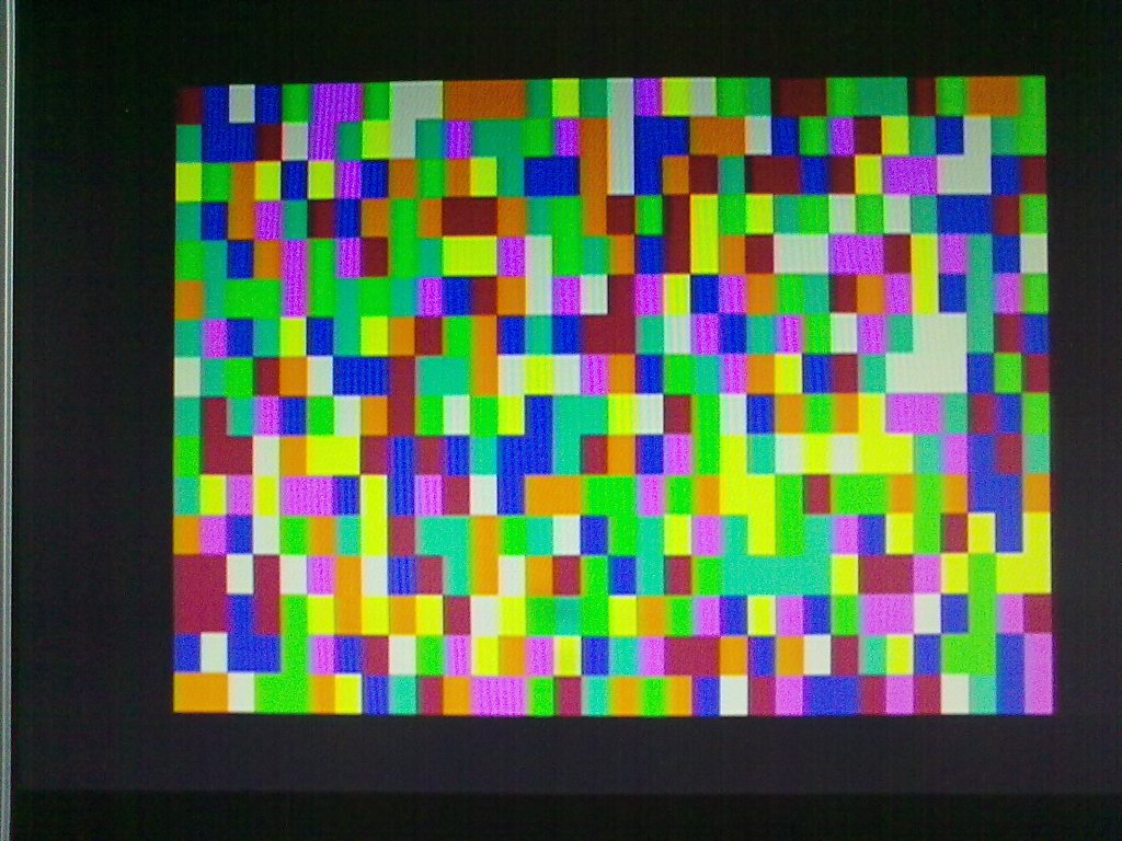

Here is a proof of principle. It works and I think it is a bit better than Composite already, but my screenshots are not really convincing when it comes to quality. Better tuning of components and shielding will probably improve it. I am not so sure my old Acer AL1731 monitor is any good at either composite nor S-video, so it would be interesting to test on another monitor.

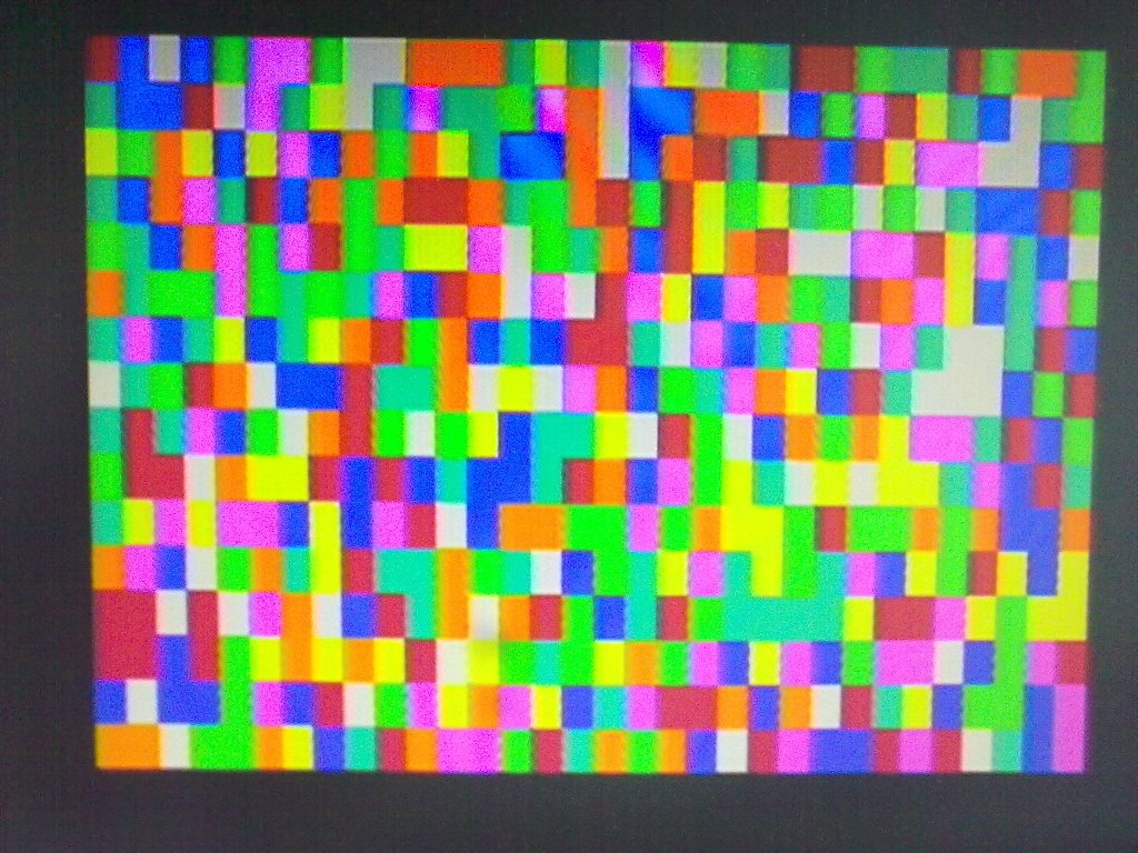

Thanks to my cellular phone camera the reference Composite screenshot looks almost better...
Normal composite output
You are maybe able to see a "snake" pattern on the left border of the composite image which is not on the S-video image. The difference is much clearer in real because the pattern is flickering, on both the left and right border.

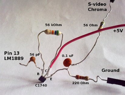

I take the S-video Luma signal from the video output of the main board (pin 6 and 5 on the connector going to the power board).
For the S-video Chroma signal, a buffer stage seemed to be needed. I made a simple emitter follower (~unity gain, low output impedance):
I have bent pin 13 of the LM1889 so that it doesn't touch the socket, thus the colour signal is not fed to the normal video output any longer. From pin 13 I have a 56 pF capacitor (C1) going to the base of a C1740 transistor, which is biased by a 56 kOhm resistor (R1) to 5V, where also the collector is connected (tapped from pin 14 on the LM1889 on the photo). On the emitter, a 220 Ohm resistor (R2) goes to ground while a 0.1 uF capacitor (C2) in series with a 56 Ohm resistor (R3) goes to the S-video Chroma input. The components are a bit random, just inspired by similar circuits and what I had lying around. The transistor is a general purpose NPN, you can use for instance a 2N2222 or 2N3904 instead.
Schematic:
                  +----------+--- 5V
                  > R1       |
Pin 13    C1      |     |/---+
  -------| |------+-----| T1
                       |\          C2       R3
                         >>--+----| |-----^^^^^----- Chroma out
                             > R2
                            --- Ground
This is what my circuit looks like:
Circuit implementation

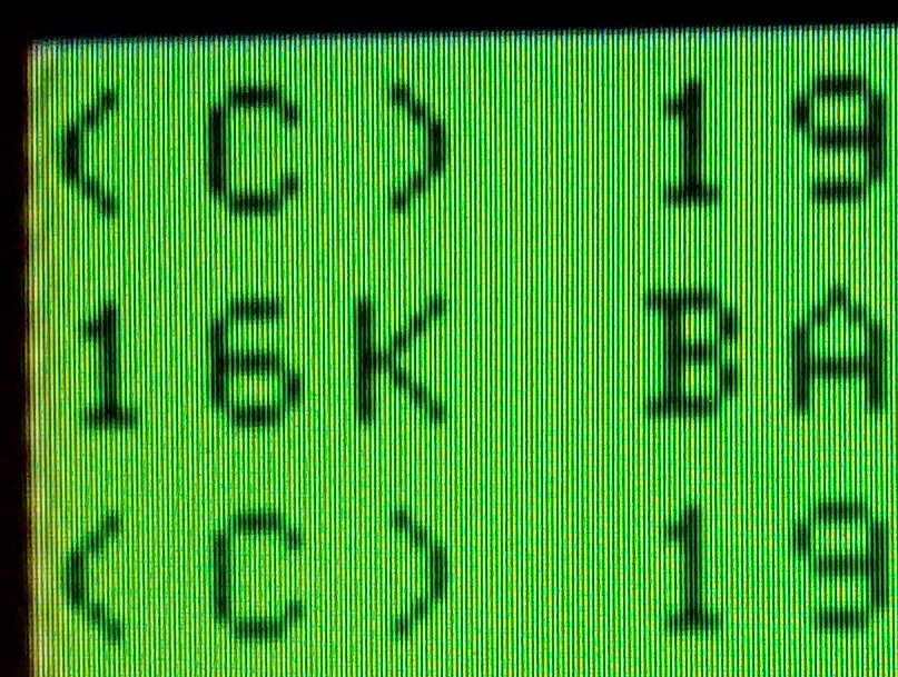

The jagged border between colours in the composite image is clearly visible here:
They are gone on the S-video image but there is some other noise (I think there is a Moire pattern caused by the camera making it look worse than it is):
