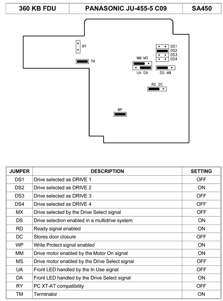

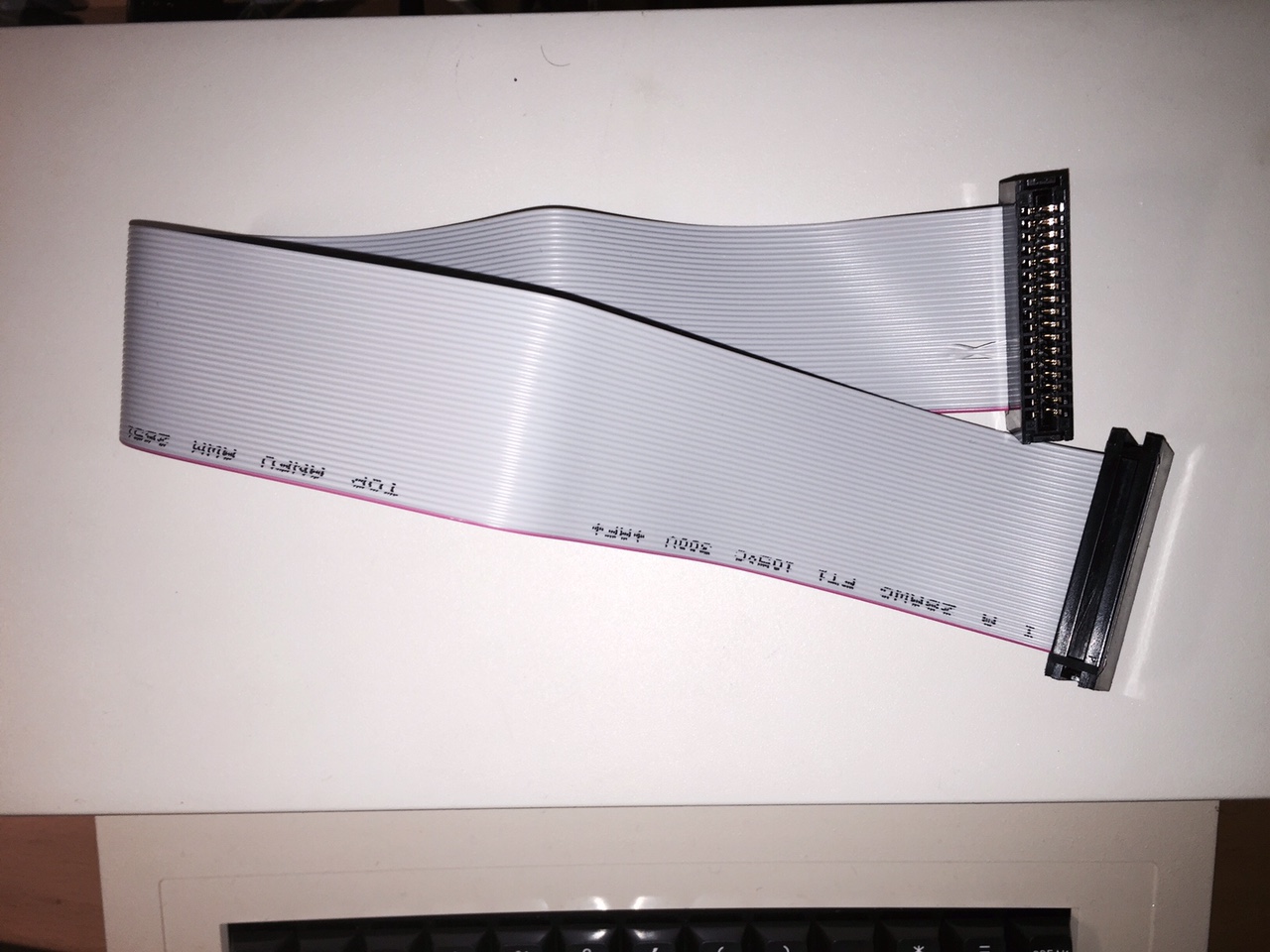

I made a simpler cable, but using robcfg's instructions.
And I'm happy to say that it works with my old Panasonic 5.25" drive. I had to fiddle a bit with some of the jumpers.
The picture above shows the default jumper positions. The obvious thing was to switch the jumper from DS2 to DS1 to make it Drive 1(0). Then the drive responded to commands, but returned a "SK Error" (seek) every time.
The jumpers that did the trick was those marked DS MX. When I changed the jumper from DS (Drive selection enebled in a multidrive system) to MX (Drive selected by the Drive Select signal) everything worked perfectly. With the jumper in the DS position, every command responded with a "SK Error", but the fact that it actually responded to commands encouraged me to just try some different jumper positions.
I will post a video later today.
Thanks for the help!!!

Hope this is the relevant place to post this. I have a single drive original Dragon floppy drive and one of Lafumat's recreated floppy controllers.
As I only have one drive, am I correct in thinking that I do not need a twist in my cable at all ? Just a straight wired floppy cable from a PC ?
Thanks for your help
John
Posts: 1716
Re: 5.25 floppy question
Yes, you are right. You only need the flat cable with no twists.
If you don't get the drive to work properly, then either the drive needs maintenance (like replacing the belt, though my drives are working with no repairs) or you have to play with the variable capacitor (the round yellow piece) and an oscilloscope, to calibrate the controller.
